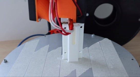

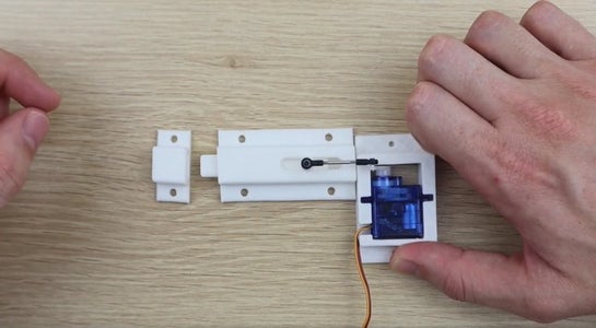

Step 1: 3D Print & Assemble the Lock Mechanism
First we'll assemble the lock mechanism, this consists of a 3D printed sliding lock and a micro servo with a servo arm.
You can also use a sliding bolt type lock which you'll need to connect the servo arm to.
The lock mechanism is based on this sliding lock design by Sagittario which I have scaled down to 65% of the original size.
Download 3D Print Files: RFID Lock 3D Print Files
I 3D printed the attached files using white PLA at 185C and 20% infill.
The mechanism and servo holder have screw holes to allow you to easily attached it to a cupboard, cabinet or drawer. You can also use hot glue or double sided tape to attached it less permanently.

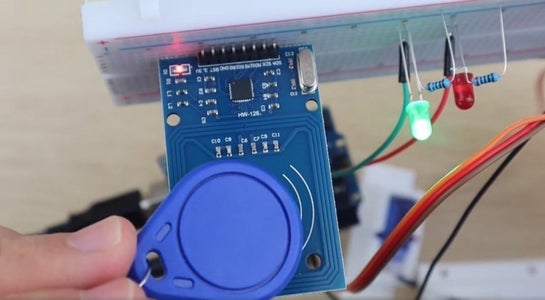

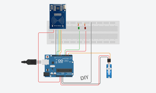

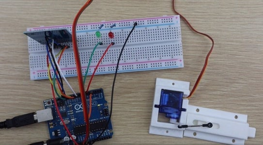

Step 2: Assemble the Electrical Components
Connect the electrical components as shown in the schematic. I assembled them onto a breadboard first in order to test the components and load the ID numbers for the two tags which I wanted to allow access to.
The green and red LEDs are not required, they just provide a good indication that the tag is being read properly once the system is in a housing.

The code essentially waits for a tag to be scanned. Once a tag is scanned, it passes the scanned ID to a function which checks if the scanned tag's ID number is in an array of accepted tags and then either grants access, flashes the green LED and unlocks or locks the mechanism depending on the previous state or denies access and flashes the red LED.
Step 4: Adding a Tag
The code includes an output to the Serial monitor on your PC. When you first run it, you'll need to register your tags which you'd like to grant access to. This is done by scanning the tag and recording the tag ID shown on your serial monitor. This number can then be added to the accessGranted array in order to grant access to the tag. The size of the array should also be increased or decreased accordingly.
Re-upload the code with the new array and you should now be able to scan your tag and it will flash green and either lock or unlock your mechanism depending on the previous state of the lock.

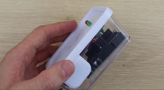

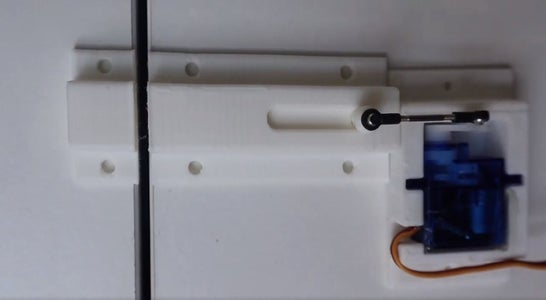

Step 5: Installing the Lock
In order to make the lock more usable, I installed it into a plastic container/housing with the LEDs visible on the front above the sensor area. The lock was then mounted onto the inside of the door.
If you'd like to make the system a bit more secure then you'll want to separate the sensor module from the Arduino and rather mount the Arduino on the inside of the door as well. It is much more difficult to reproduce the signal from the sensor module to the Arduino than it is to reproduce an PWM signal to the servo to open the lock.
