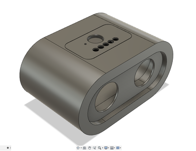

For the casing:
- 25 mm MDF (1" for overseas maker colleagues)
- 4 mm plywood or MDF for the speaker plate (1/8"). I used scrap wood I had laying around
- Speaker fabric
- Hot glue gun
- Wood screws (I used matte black drywall screws because I liked their look better)
- MDF filler
- Wood laquer

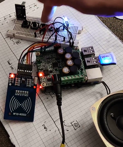

Step 1: The Electronics
Once you have decided on the HiFi and RFID modules, you get to branch everything together for the first time. I think this is one of the most fun parts besides watching the kids play with their new toy when it's finished. Unless you release the magic smoke that is (never happens to me)...
The HiFi module can just be pressed on the GPIO header and it comes with metal standoffs for nice and sturdy attachment. As mentioned before, the HiFi module's manual says that it renders the GPIO pins unusable, but this has proved not to be the case. The module also powers the Pi which eliminates the need for more than one power supply and makes wiring a lot easier.
The NFC module requires some cabling, for which I followed this guide but I changed the 3.3V and GND pins to be able to use a single 4x2 connector on the Pi's side:
- GPIO 17 to 3.3V
- GPIO 19 to MOSI
- GPIO 20 to GND
- GPIO 21 to MISO
- GPIO 22 to RST
- GPIO 23 to SCK
- GPIO 24 to SDA
The buttons all use the internal pull-down resistors of the raspberry pi so they should be wired so that they provide 5V to the corresponding pin when pushed. For this I made a custom circuit board that spaces the buttons evenly, distributes the 5V of the Pi to all buttons and can be attached to a 3D printed controls plate (more on this later). This means:
- GPIO 2 or 4 to the first button and branched (with jumpers) to the other buttons (5V)
- Play/pause button to GPIO 38
- Stop button to GPIO 31
- Next button to GPIO 33
- Vol up button to GPIO 11
- Vol dn button to GPIO 13
And as an indicator that shows that the radio is ready to start playing I added an LED on a separate circuit board. It's attached to GPIO 36 and has a 220Ohm resistor connecting it to ground on the negative lead.

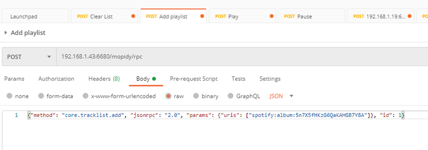

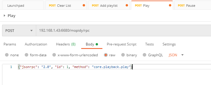

Testing Mopidy and http commands with Postman
14. If you have done everything right and attach a speaker to the module, you should now be able to start playing some music remotely. For testing, and getting to know http post commands really, I used Postman. I really had to dive into the core API description of Mopidy in order to get the commands to work because I had no experience with this kind of thing. But eventually I figured it out with some help from my brother. Watch the images for the correct settings, I added examples for adding to Mopidy's tracklist and for starting playback.
As soon as you add songs to the tracklist, you should get a response from Mopidy containing all the tracks you added. And when you send the play-command the music should start playing almost immediately. There are already a lot of links in the chain so troubleshooting can take a while. If you get no sound, be sure to check the amp hat's configuration by playing a test sound. Maybe try with something plugged in the Pi's audio jack too.
If you don't get '200 - OK' response codes in Postman, there is a connection error and you should check the IP address, port and Mopidy's config file.
If you do get an '200 - OK' response code but an error in the feedback, there might be a problem with the post command or the format it's in.

Step 3: The Enclosure - Part I, the Design
The enclosure was also going to be lot of work and I wanted it to be good. I started from the idea of a vintage bakelite radio but I didn't see how to do that easily. Then I found this (very useful!) video on MDF 'kerfing' and the idea on what it should look like started to form.
I started by drawing the radio in Fusion 360 (which is free for personal use) which allowed me to make the idea I had more specific and to see where the problems would lie. Some iterations were needed because of the limitations of the machines I have available. I designed it so it can be made with a circular saw and a simple hand router, although that didn't prove easy.
Once I was happy with the general look I drew it in detail. First I designed the control panel so it could hold breakout boards containing the necessary electronics. Then I drew the shell with a cutout for the control panel. (There seems to be a slight problem with importing the assembly in Tinkercad, sorry for the faults in the design. The STL should be fine though).
Step 4: The Enclosure - Part II, Outer Shell and Control Plate Cutout
