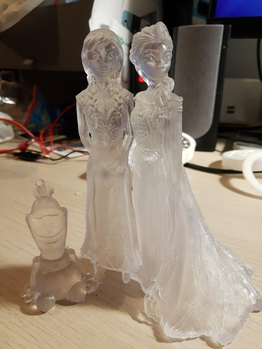

It all started with a once-in-a-long-time offer from the 3D printing and CNC machining service, Weerg (not affiliated): try out their clear, translucent resin 3D printing for an astonishing price of 0€!
This was around the time I’d finished the RGB Butterfly, and I was looking to build another night light for the kid. At that time, she was heavily into the Frozen, so after a bit of Internet searching I found this beautiful model.
This was too much of an opportunity to pass up on…

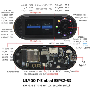

  1. Lilygo T-Embed

Note that except for the T-Embed dev board, you don’t have to use the exact same components from the list above. Design is flexible enough to accommodate different hardware, as long it is supported by the software (Home Assistant, ESPHome).
Even the T-Embed could be replaced by a similar development board, but it is slightly trickier because part of the casing design would have to switched to match the alternative module. Totally doable, though.
The voltage converter is adjusted to reduce and stabilize the output voltage at approximately 4.2V-4.7V (it’ll drop down even further when the LEDs are on) from the 5V supplied by the USB. The converter’s output is used to supply both LEDs and the T-Embed module.
If you’re using different ESP32 module, make sure that the output voltage of the converter is safe for that module.
The WS2811 LEDs can be supplied by voltages anywhere in the 3.3 - 5V range. T-Embed is meant to be powered from a USB connection, so it expects input to be at around 5V. It comes with its own voltage stabilizers dropping the voltage down to 3.3V.
The RFID module and the LCD screen both require 3.3V, so they’ll be powered directly from the 3.3V pin on the T-Embed. They probably could be connected directly to voltage converter’s output, but if you would like to do that, make sure that modules you’re using are 5V tolerant.

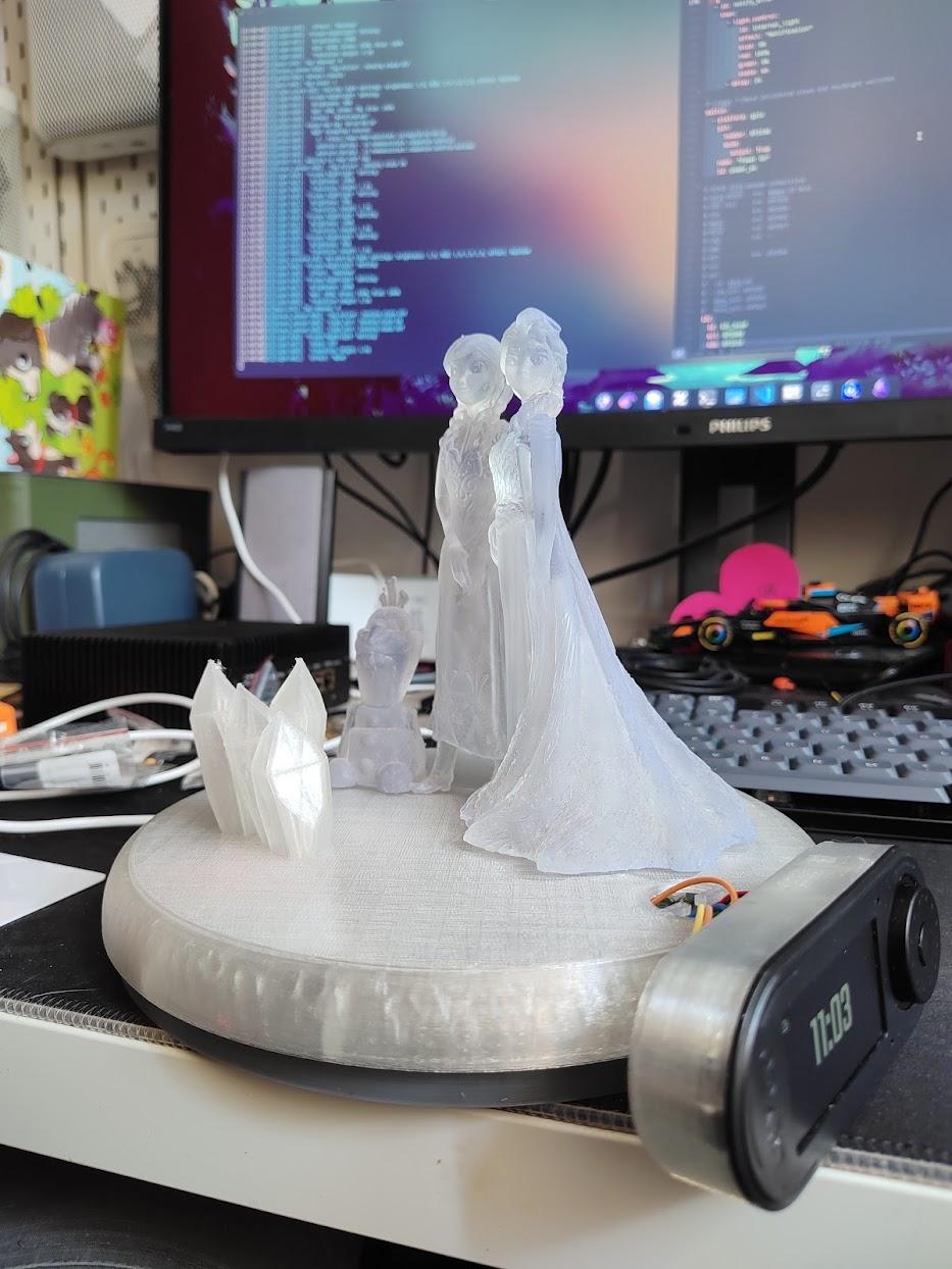

And here's how it turned out for me. Eventually (it took a lot of time and a lots of turns).
Check out the next steps for source files of the ESPHome project and the Home Assistant automations.

# Lilygo T-Embed peripheral power and backlight switches
switch:
- platform: gpio
pin:
number: GPIO46
mode:
output: True
# RC522 RFID module connections
# RFID-RC522 <-> Wemos D1 Mini
# SDA (SS) <-> GPIO16
# SCK <-> GPIO22
# MOSI <-> GPIO21
# MISO <-> GPIO17
# IRQ <-> -
# GND
# RST <-> GPIO04
# VCC
# spi:
# id: rfid_spi
# clk_pin: GPIO22
# mosi_pin: GPIO21
# miso_pin: GPIO17
i2c:
scl: GPIO08
sda: GPIO18
scan: True
pn532_i2c:
update_interval: 1s
i2c_id: i2c_bus0
on_tag_removed:

# Display
spi:
clk_pin: GPIO12
mosi_pin: GPIO11
font:
- file: "gfonts://Teko"
- file: "gfonts://Material+Symbols+Outlined"
glyphs: [
"\U0000e63e", # wifi
"\U0000e648", # wifi-off
"\U0000e2bf", # cloud-done
"\U0000e2c1", # cloud-off
"\U0000e037", # play-arrow
"\U0000e034", # pause
glyphs: [
display:
- platform: st7789v
model: LILYGO_T-EMBED_170X320
cs_pin: GPIO10
dc_pin: GPIO13
backlight_pin: GPIO15
reset_pin: GPIO09
update_interval: 10s
auto_clear_enabled: true
spi_id: display_spi
lambda: |-
it.strftime(80, 16, id(disp_font), "%H:%M", id(home_time).now());
if (id(ha_api)->is_connected()) {
it.printf(0, 8, id(icons_20), "\U0000e2bf");
} else {
it.printf(0, 8, id(icons_20), "\U0000e2c1");
