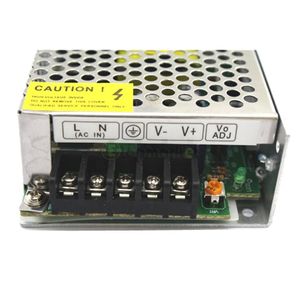

Step 3: POWER
The biggest thing you will have to worry about for any electronic security system is power. The lock I picked is a 24V DC electromagnetic lock. They come in varying voltages, but I prefer the 24V for stability. Some of my other instructables show it better, but I have several power supplies connected in various ways behind what I affectionately term my "command station." I have a dedicated 120V AC to 24V DC transformer just for the mag lock. It's connected to part of a backup power supply which powers more stuff should the power be cut. If power goes out for any reason (storm, intentional switch off, etc.) the backup will keep the mag lock operational for about an hour. That's probably overkill, but since I use the backup for computers and other aspects regardless of the access control system, it didn't hurt to hook it up as well.

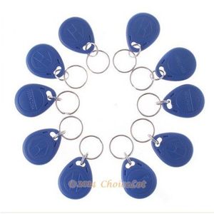

Step 6: Code Entry
I chose an access panel which has both a keypad and can read an RFID signal. Each panel out there has it's own programming pattern. This panel was pretty simple and just required scanning the fobs while in programing mode. I like using a system with a redundancy for entry just in case one of the reading mechanisms fail.
