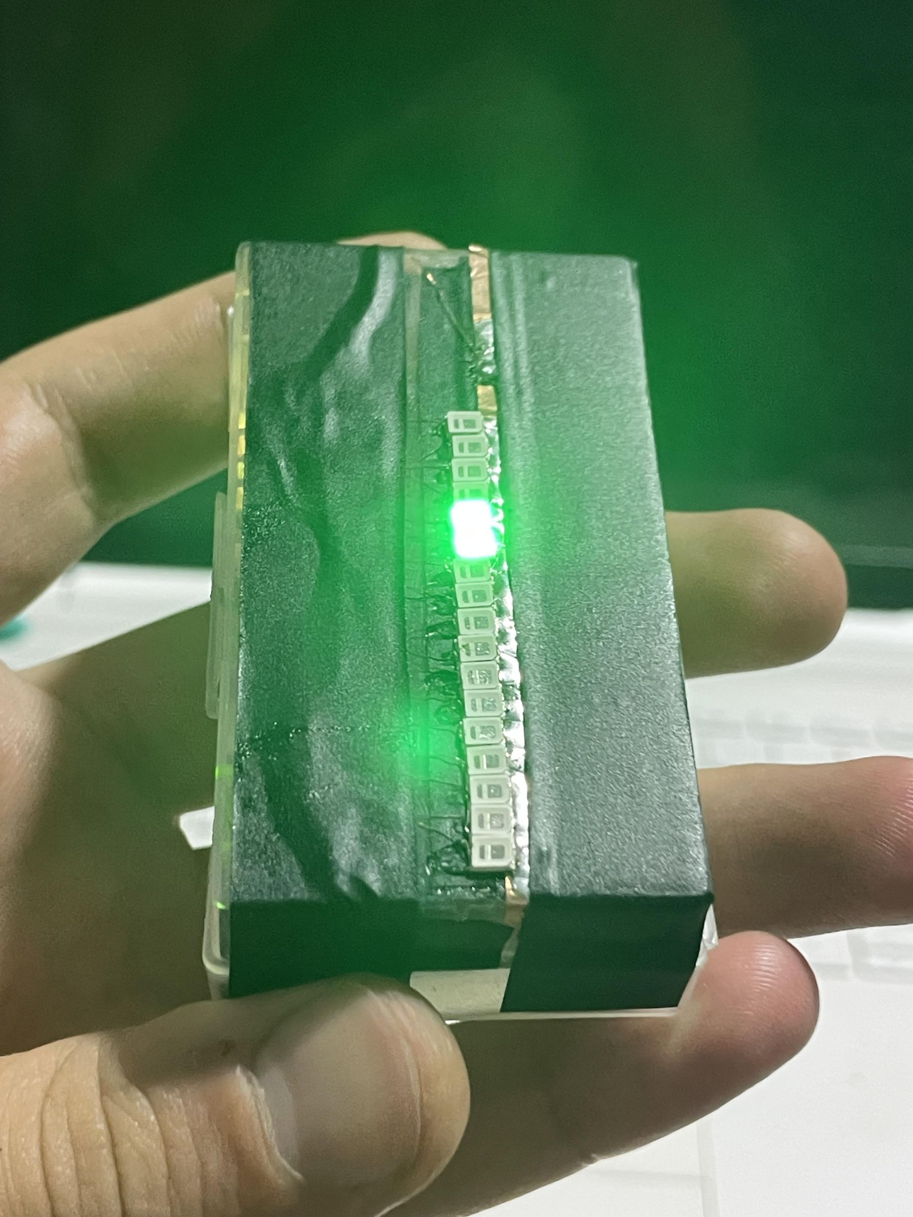

Step 6: RFID Tag Modification (Optional But Fun!)
Want to turn your RFID tag into a wearable item? Here’s how:
  1. Open the RFID tag carefully using a hobby knife or prying tool.
  2. Remove the coil and RFID chip.
  3. Carefully solder wires from the chip pads to a smaller custom coil or embed the chip directly into a necklace or keychain design.
  4. Secure with epoxy or hot glue and conceal within your wearable.
⚠️ Warning: RFID chips are fragile. Only attempt this if you’re comfortable with delicate soldering.
