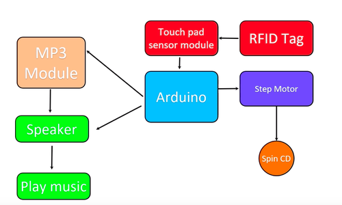

Step 1: Control System
How the music player works is by scanning an R.F.I.D (Radio-frequency identification) card to the R.F.I.D reader
The R.F.I.D reader is then read by the Arduino to check to see if the card tag is already within the tag list (already in the system) or a new tag.
If that comes out true (meaning the tag is already on the list) the Arduino will do 2 things
  1. It will communicate with the mp3 module to see which song is associated with the card tag that was scanned and the play said song
  2. Power up the stepper motor and spin a cd of your choice for display

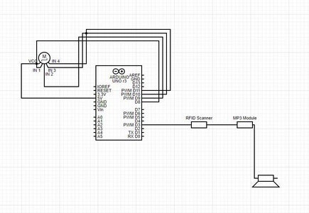

Step 4: Circuit Schematic
Above is a quick schematic of how the circuit it put together. The software i used for the circuit schematic did not have some of the modules that my project used such as the mp3 module and the rfid scanner.

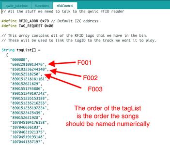

Step 5: Code
Below is all of the code I used to get the project working. In the rfidControl.ino you are able to change the taglist to your specific id numbers. Make sure to keep the code together in tabs.
Step 6: Upload Music on the Sd Card
To play the songs, you would have to upload mp3 files onto a micro SD card and name them a specific phrase.
  1. Open up the sd on your computer
  2. Upload mp3 files onto the sd card
  3. Name them appropriately
  4. "F001.mp3"
  5. "F002.mp3"
  6. "F003.mp3"

Wiring - I used digital pins 8,9,10,11 to control the stepper motor. I then connected ground to ground on the Arduino and then positive to 5v on the Arduino. You would need females to male cables (you need 6).
