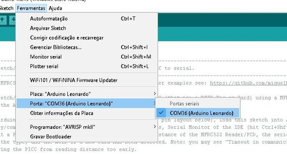

Open the firmware on the arduino, and indicate the port that your hardware was identified.

Step 4: Upload Firmware
After the compilation is complete, click on the record button, as shown in the figure below:

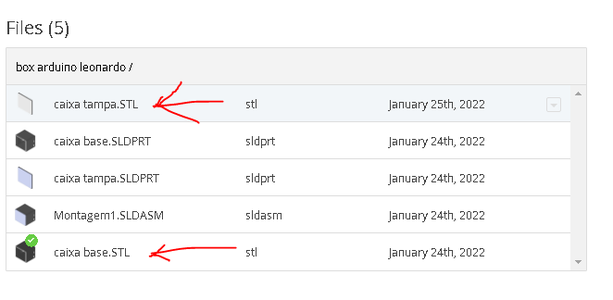

Step 5: Printing Plastic Boxes
To print the plastic boxes, you will need to download the project:
https://grabcad.com/library/box-arduino-leonardo-1
In this project there are 2 files with .stl extension.
On your 3D printer of choice, print these two files.

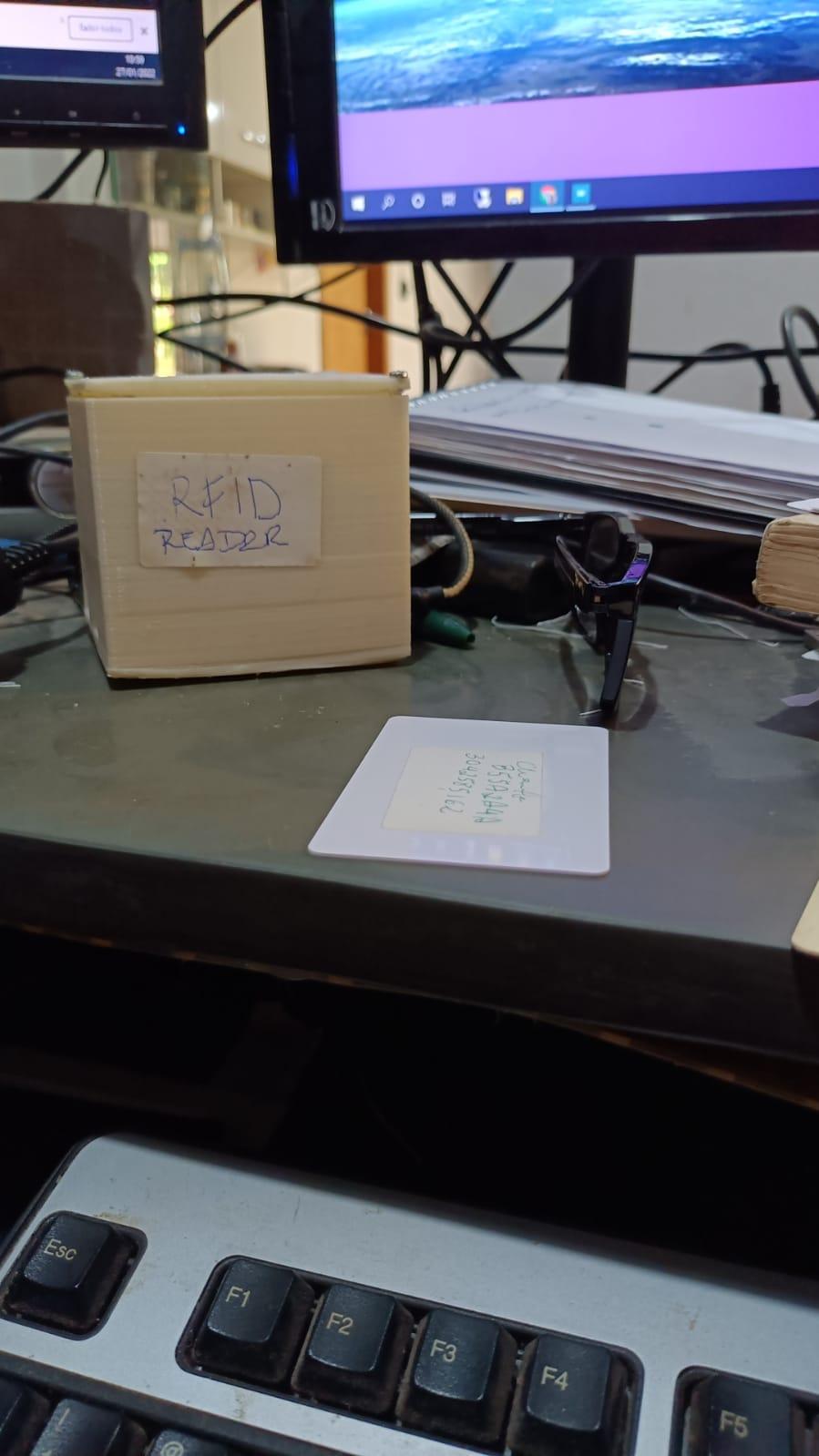

Step 6: Assembly of the Box
The Arduino Leonardo will be connected to the bottom of the box, so use two Phillips M3x12 screws.
RFID Reader Fixing
The RFID Reader will be fixed on the side or on the top face according to the installer's convenience.
For this we recommend the use of super strong glue or hot glue.
We chose not to set the Reader's location, as we understand that this is a user's option.
In my case, I fixed it on the side, pasting a label on the external area, identifying the reading point.
