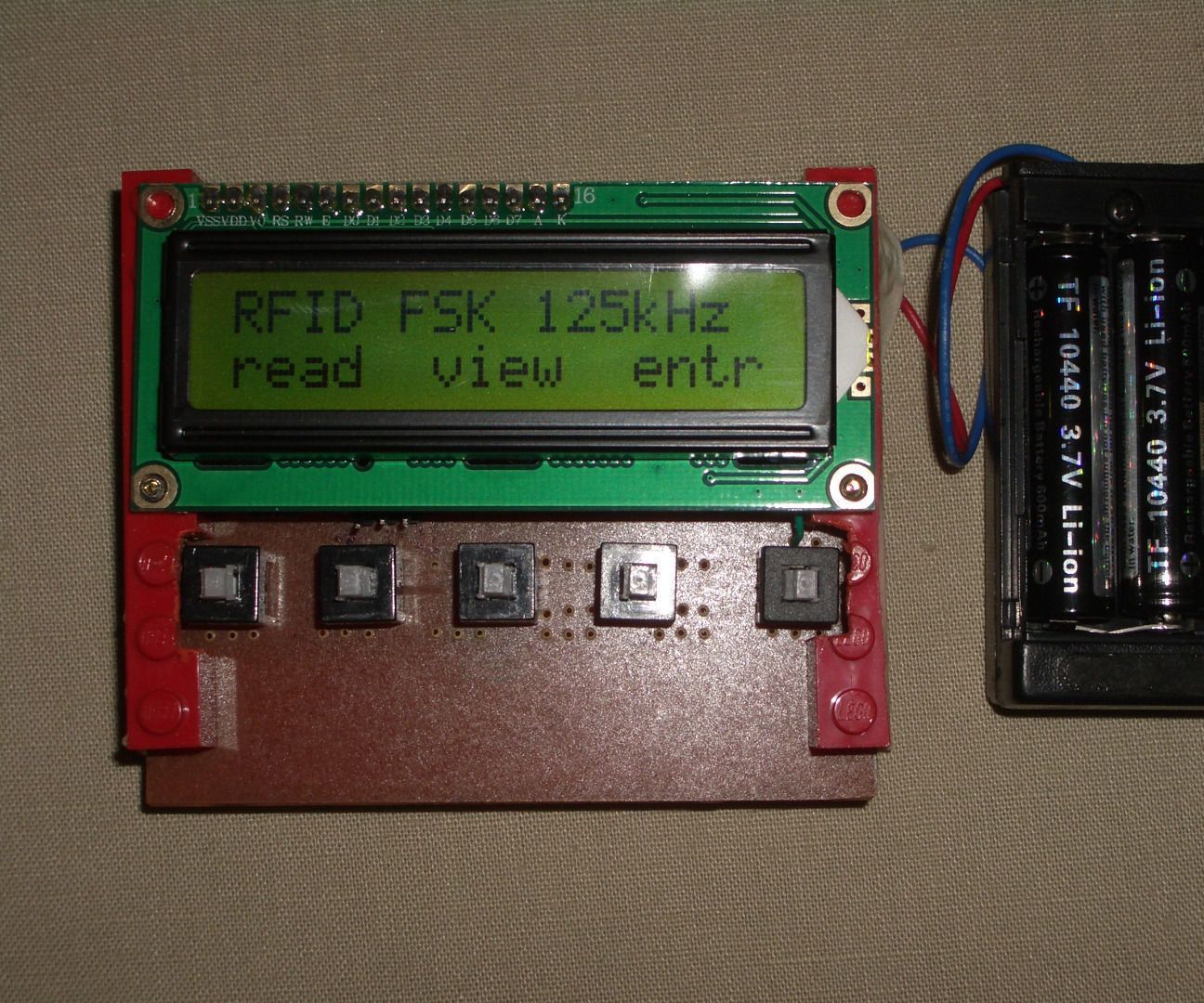

Introduction: RFID Reader – Access Control System
This device is a simple access control system which uses RFID cards. It is designed with PIC12F1822 microcontroller running on internal oscillator at 16MHz. It generates 125 KHz carrier frequency and decodes the respond data stream – format H10301- FSK modulation 26 bits only. These cards (made by HID and other companies) are widely used in US.

RFID reader connected to a computer
Read cards and sends information (facility code and card number) to PC in hex format. The connection is RS232 at 57600 baud rate with TTL levels. I use a USB to RS232 TTL converter cable (they are cheap and there is a lots to sell on eBay) and terminal program like http://sites.google.com/site/terminalbpp/
The read card information shows like:
67 89AB where 67 is facility code (hex) and 89AB is card number (hex).
