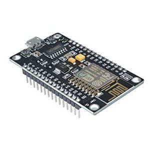

- NodeMCU ESP8266 (or any other board)

- Connect NODEMCU ESP8266 Pin [3V3] to RFID pin [3.3V]
- Connect NODEMCU ESP8266 Pin [3V3] to OLED pin [Vcc]
- Connect NODEMCU ESP8266 Pin [GND] to RFID pin [GND]
- Connect NODEMCU ESP8266 Pin [GND] to OLED pin [GND]
- Connect NODEMCU ESP8266 Pin [D1] to RFID pin [RST]
- Connect NODEMCU ESP8266 Pin [D2] to RFID pin [SDA]
- Connect NODEMCU ESP8266 Pin [D3] to OLED pin [SCL]
- Connect NODEMCU ESP8266 Pin [D4] to OLED pin [SDA]
- Connect NODEMCU ESP8266 Pin [D5] to RFID pin [SCK]
- Connect NODEMCU ESP8266 Pin [D6] to RFID pin [MISO]
- Connect NODEMCU ESP8266 Pin [D7] to RFID pin [MOSI]

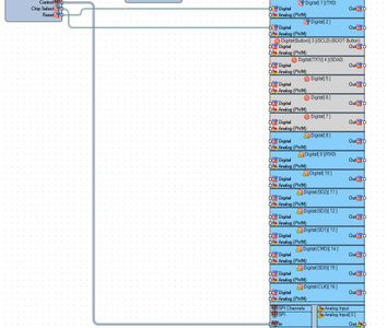

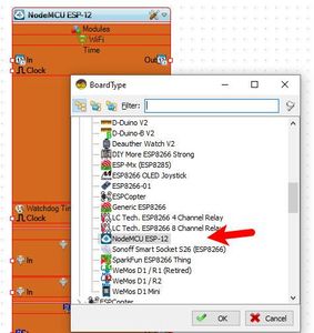

Start Visuino as shown in the first picture Click on the "Tools" button on the Arduino component (Picture 1) in Visuino When the dialog appears, select "NodeMCU ESP-12" as shown on Picture 2

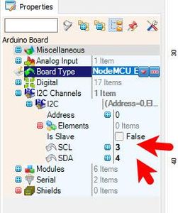

- In Visuino Select "NodeMCU ESP-12" board and in the properties window set I2C pin [SCL] to 3 and set I2C pin [SDA] to 4

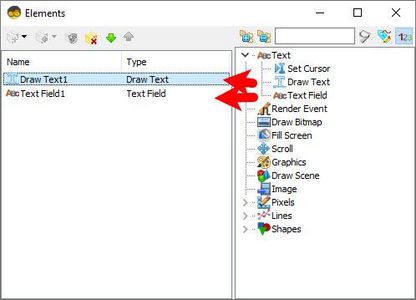

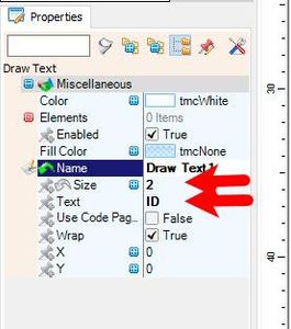

- Double click on the "DisplayOLED1" and in the "Elements" window drag "Draw text" to the left side and in the properties window set "Size" to 2 and "Text" to ID

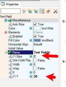

- Drag "Text Field" to the left side and in the properties window set "Size" to 2 and "Y" to 30
- Close the "Elements" window

- Connect "RFID5221" pin [SPI] to "NodeMCU ESP-12" pin [SPI]
- Connect "RFID5221" pin [Chip Select] to "NodeMCU ESP-12" digital pin [2]
- Connect "RFID5221" pin [Reset] to "NodeMCU ESP-12" digital pin [1]
- Connect "RFID5221" Key pin [Out] to "DisplayOLED1" > "TextField1 " pin [In]
- Connect "DisplayOLED1" Out pin [I2C] to "NodeMCU ESP-12" I2C pin [In]
