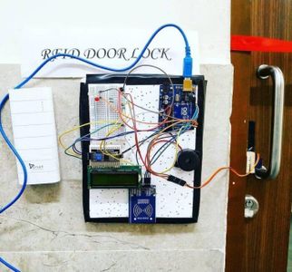

Hello Guys, Welcome back to another interesting Project related to Arduino. Today, we're going to make an RFID Security System with used RFID Tags to authenticate something. We'll use basic hardware and module which are available in the market like I2C LCD. Also, we'll provide full code and Circuit Diagram further. So, let's talk about basic hardware & modules we’re going to use.
I2C LCD is the device which is used to display characters on it. Generally it uses 7-bit mode for making communication with Arduino, but for reduction of pins and easiness we use I2C module for It. Also, as many I2C devices can be connected simultaneously. So There won't be shortage of the pins.
RFID module uses I2C communication to Read & Write the RFID Tags and to authenticate It. Due to its low quality only some type of RFID tags can be read and write so don't try other and get misguided.
For more information related to other modules used, visit my original post.

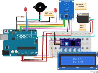

Step 1: Material Required
  • Arduino UNO
  • 16×2 LCD and I2C module
  • Servo motor
  • Buzzer
  • Green and Red LED
  • Jumper wires
  • Breadboard
  • RC522 RFID module
  • 220-ohm resistors and a 10K potentiometer
  • USB cable for uploading the code
Step 2: Circuit Diagram

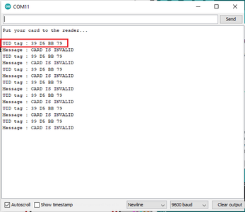

  //Show UID on serial monitor
  Serial.print("UID tag :");
  String content= "";
  byte letter;
  for (byte i = 0; i < mfrc522.uid.size; i++)
    Serial.print(mfrc522.uid.uidByte[i] < 0x10 ? " 0" : " ");
    Serial.print(mfrc522.uid.uidByte[i], HEX);
    content.concat(String(mfrc522.uid.uidByte[i] < 0x10 ? " 0" : " "));
    content.concat(String(mfrc522.uid.uidByte[i], HEX));
  Serial.println();
  Serial.print("Message : ");
  content.toUpperCase();

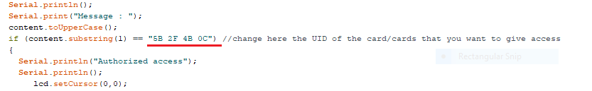

  if (content.substring(1) == "5B 2F 4B 0C") //change here the UID of the card/cards that you want to give access
