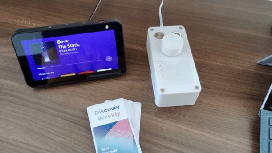

Using a Raspberry Pi with an RFID-reader, any album and playlist can be connected to a card. Also the desired playback device can be selected with a setup card.
The result is a digital jukebox with volume control, pause, skip and shuffle button that can control any device that supports Spotify Connect.

Step 2: Printing the Case
I decided to use a 3D printed case for the prototype. Unfortunately, it is not really aesthetic but very flexible in creation and use.
However, in the future a wooden case is planned.
Files are attached, nothing special to consider here. The design is so simple, I printed it at 0.26mm to finish faster.
The knob was just pressed-fitted on the Rotary encoder.
