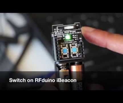

  1. Place the battery shield, OLED display and LSM303 on the mini-breadboard.
  2. Place the RFduino DIP BLE board into the battery shield.
  3. Using jumper wires, connect the components. Connect the OLED display and LSM303 ground and VCC terminals to the corresponding 3.3V and ground headers on the battery shield. Connect the SCL lines of the OLED display and LSM303 to GPIO5 on the RFduino as well as the SDA lines to GPIO6.
Step 4: Using the Compass
Turn on the compass using the toggle switch on the battery shield. Keeping the compass level, it can be pointed in any direction and that direction will be shown on the OLED display. Using the associated Windows 8.1 application, a command to calibrate the compass can be sent to initiate a calibration. To calibrate the compass, while keeping the compass level, slowly spin the compass in complete circles multiple times. The display will count down from 10 such that you know how much time remains during the calibration operation. Placing the compass on a turntable, as shown, makes the spinning much easier during calibration.
