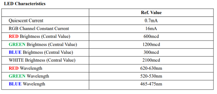

Hi guys, today we are going to discuss, interfacing of neo pixel led through NodeMCU (ESP8266-12E). Neopixel is addressable led, we can program to display any number/name in any color using microcontroller. Neo pixel came in different smd packages, here we are using Ws2812b-5050 mini RGB.
This mini led has voltage ratings: 3.0v to 5.5volts @16mA (for each Led). Our NodeMCU has 3.3-volt regulator, to drive all the LED’s properly.

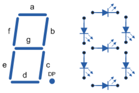

Step 2: Making 7 Segment Display Using Neo Pixel Led:

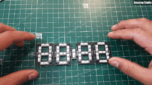

Here, I do all the power connections in parallel and all the Data connection in series. Using the 7-segment display method, and connect all the LED’s in proper format (As in diagram)
Each of the segment has 2 LED’s and One whole panel has 14 LED’s in total. We need 4 panels to display time (2 for Hours, 2 for minutes). Two more panels can be connected to display seconds/any other values like Temperature.
Always connect Dout of first panel to Din of second.

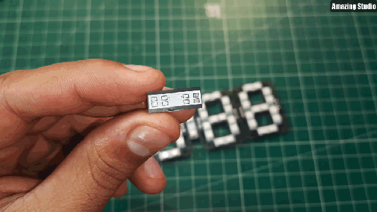

Step 3: Dash Connections:
To connect the hours and minutes panel, A small PCB is there in between named as Dash, contains 2 LED’s as binary digits. These 2 LED’s glow after each second.

Step 8: 7- Segment Clock:
Now, we have 4 panels and one dash. Connect 2 panels in series in pair.Now connect dash in between and connect NodeMCU using schematics given above

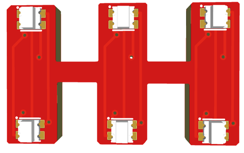

Step 12: PCB Design:
This is the main PCB design which is used to display the digits and other letters. Download all the Required files regarding this project from here.
Step 13: This Is the Design to 2nd Pcb Named As Dash.
