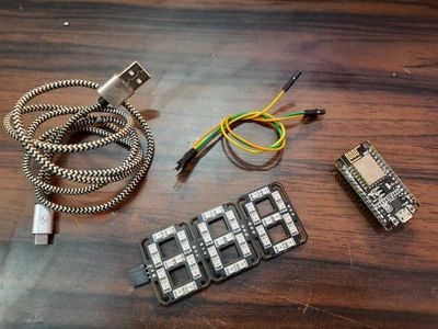

TO display any Animations or Number on this 7 segment panel we need some components as follows:
1) NodeMcu or Arduino
2) Breadboard
3) 7 segment panels
4) USB and other connecting wires.

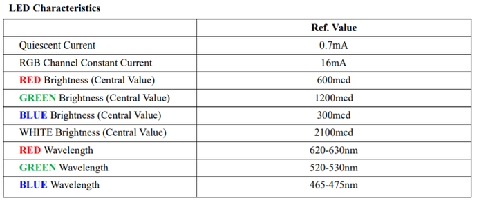

Step 1: About Ws2812 Led
Hi guys, today we are going to discuss, interfacing of neo pixel led through Nodemcu (ESP8266-12E). Neo pixel is addressable led; we can program to display any number/name in any color using microcontroller. Neo pixel came in different smd packages, here we are using Ws2812b-5050 mini RGB.
This mini led has voltage ratings: 3.0v to 5.5volts @16mA (for each Led). Our Nodemcu has 3.3-volt regulator, to drive all the Led’s properly. Other details are given in the above image.

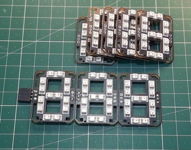

Now, Turn Your schematics into PCB and arrange the Led’s in the format of general 7 segment display. Here you can get an example of this.
Step 5: Making PCB:
Making a beautiful looking PCB is equally important. So, I designed the PCB, started with a rectangular board outline then adding different type of board cut-out to PCB. Finally, this image may show my work to you.
Make connection of all the nets and tracks, build the copper area using GND connections for top and bottom layer. Connections can be done using Auto route/ EasyEDA is the best software for this type of work. And JLCPCB is the best PCB manufacturer for low cost and quality.

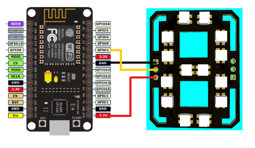

Step 6: Circuit Diagram
Always connect Data out of 1st led to Data in of 2nd led, Power connections are done in parallel. This led's can run on 3.3v without any resistor. So please keep in mind to add resistor on each led while working with high voltages.
Step 7: Connection With Nodemcu:
Connect:
1) GND pin to Gnd of nodemcu
2) VCC pin to 3.3volts
3) Data IN pin to D4/ GPIO2
Step 8: SMT Assembly Service:
Instead of ordering simple PCB’s from JLCPCB, I tried SMT assembly service in just a price of $7 + component charges. Soldering and placing components on PCB’s are done in this process. So, I just have to unbox the PCB and use them directly.
Here is the received package and PCB’s. Quality of PCB’s are very good and every component is soldered on its exact place. Have a look on the SMT service, try this and get coupons of worth $30 on first Sign-up using our link.

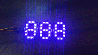

Step 10: Testing With Different Examples:
1) Counter:
Up-down counter is there in the code, We can change the counting 0 to 999 and delay between each count.

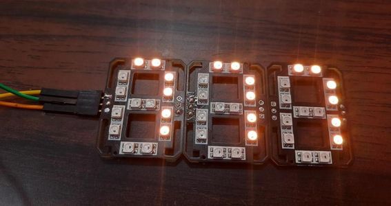

Step 11: 2) to Display Numbers
Numbers displayed on each segment are of same color at a time. In the code color can be changed using the function.
RGB:
Red(brightness,0,0)
Green(0,brightness,0)
Blue(0,0,brightness)
Step 12: 3) Showing Animations:
Each pixel contains 2 led so animations can be drawn in this format, also the costom color can be obtained by making any two from RGB to High.
example:
Pink: RGB = (brightness,brightness,0)
