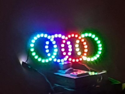

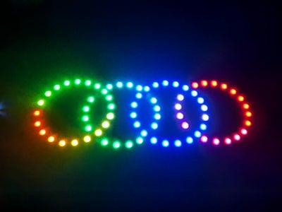

Just to display and showcase the effect of RGB with ws2812 neo-pixels. Experimenting different codes and effects with rings,

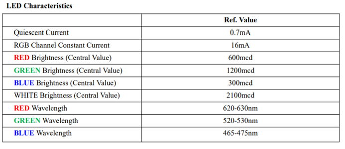

Step 2: Led Specifications:
Here we are using 5mm*5mm WS2812 RGB addressable led's. These led have a special inbuild chip which give them address to glow. Using MCU we can generate an analog value between 0-255 in which is also defined in the code as 0- brightness.
Now take 3 different value like (0,125,255) the first value represent the intensity of red color, second & third represent green and blue respectively. By changing the values we can represent different color scheme.
This mini Led can be operated in the voltage of range of 3.3 to 5 volts without any external resistor. Although we can control the brightness through the code.
Step 3: Making of an RGB Ring:
I want to make a large one, which is not available in market, so JLCPCB comes to my mind and then I think to go with SMT service. So I made a schematics using EasyEDA and choose a proper component which is cheap and in stock.

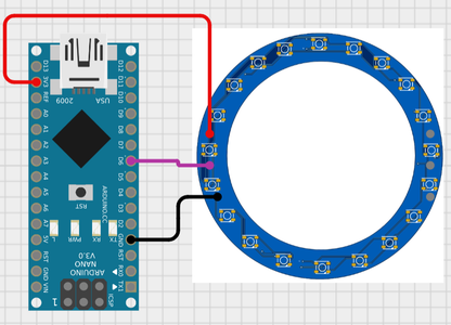

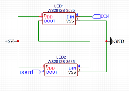

Step 4: Circuit Diagram:
Step 5: Circuit Description:
I connected all the LED's in parallel and made the all the data connection in series. Keeping an eye on input and output, some headers are placed accordingly. Making all the power connection in parallel is easy and can be power directly through microcontroller line. One panel/ring has 20 Led's and in this manner you can connect them all.

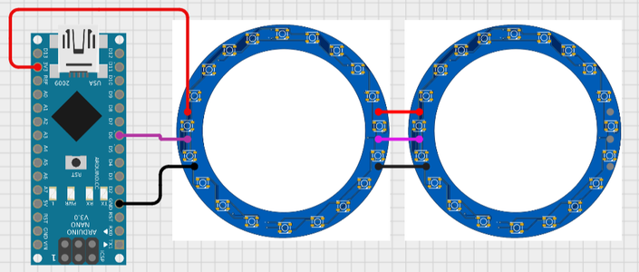

Step 8: Arduino Circuit:
As mentioned in the code, connect data line to D6. connect the power +5v and ground. To join 2 or more RGB rings together we can do these connection and the code will be modified according to the number of led's as described above.

Step 12: Troubleshooting:
1) Din is always connected to Dout in series with on e another, if connected in opposite or disconnected from anywhere whole setup stops working.
2) Make sure all the connections are properly soldered, dry soldering will cause change in data value and color.
