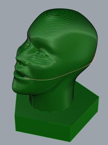

Step 1: 3D Model Slicing
  1. Download Slicer for Fusion 360: https://knowledge.autodesk.com/sites/default/files/file_downloads/Slicer_For_Fusion360.exe.zip
  2. Install Slicer for Fusion 360
  3. Start it
  4. Open Example Shapes -> Human Head
  5. Click Manufacturing Settings and change some settings at the bottom of window
  6. Material Size Units -> mm
  7. Thickness -> 1,25mm
  8. Scale width that its fit on CD ->120mm
  9. Construction Technique -> Stacked Slices
  10. Activate Dowels -> Diameter 12mm and align it to the middle of Head. Thats the middle of CD
  11. Click on Get Plans
  12. File Type -> DXF -> mm
  13. Export to my Computer

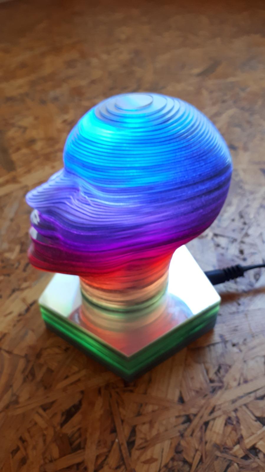

Step 3: Assembling
After milling the parts, it's time to assemble them.
We numbered all the parts during the milling process.
Now all the parts are simply put onto the 12mm acrylic tube one by one and fixed with a drop of instant glue.
Then cut the WS2812 led strip into two strips of equal length and stick them together with the back side.
Make sure that the LED strips run in the right direction. (The WS2812 LED strips can only be fed from one side, otherwise they will not work)
Now solder the cables to it. Make sure that the polarity is correct.
Connect it to the controller and push it into the tube.
Plug in the power supply unit and you're done
Step 4: Done
Finally, after almost 20 years, the project is finished.
