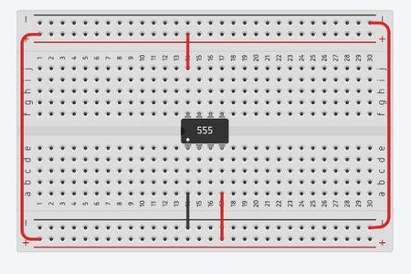

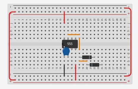

Step 1: Voltage Connections
Place 555 timer IC on the bread board and make positive (+) and negative (-) voltage connections.
pin 1 = negative
pin 4,8 = positive

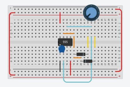

Step 2: Diode & Capacitor
- Connect 100nF capacitor with pins 1 and 2
- Connect positive (anode) end of one diode with negative (cathode) of other diode and connect the common point with pin 7

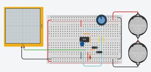

Step 3: Connecting Potentiometer
- Place a 5k ohm potentiometer on breadboard and connect its middle pin with pin 6 and pin 2 of IC
- Also connect 1st and 3rd pin of potentiometer with the diodes common pin.

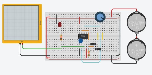

Step 4: Connecting Battery & LED

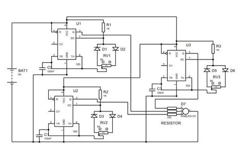

- Add a 1K ohm resistor b/w common pin of diode and positive pin of power supply and connect oscilloscope with pin 3 which is the output pin
- Connect led with pin 3 using 330 ohm resistor and by rotating the potentiometer we can see the change in brightness of LED and a variable signal on oscilloscope.

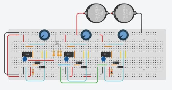

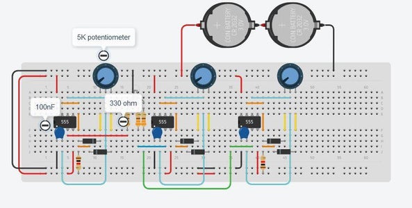

- To change the color of RGB we need 3 of these circuits because RGB has 3 diodes.
Step 5: Final Circuit
This circuit is created using the same method shown above. So by rotating these three potentiometers we can control the colors of the RGB led
