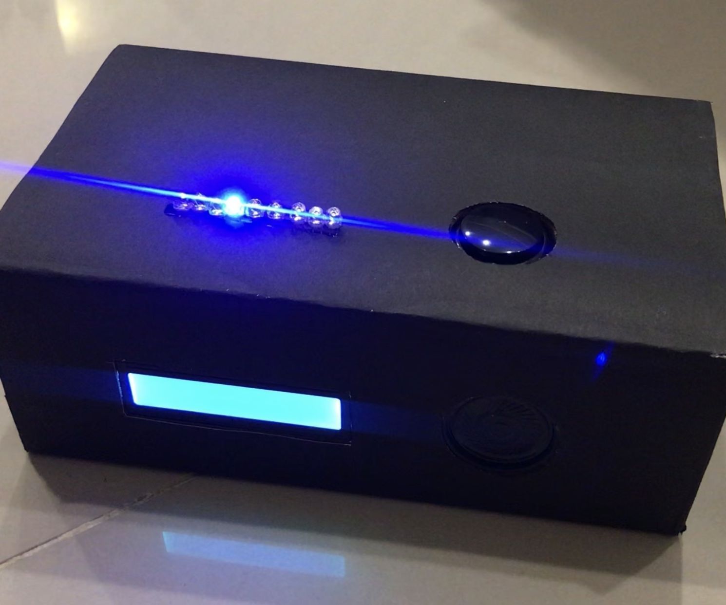

Introduction: RGB LED & Breathing Mood Light
The RGB LED & Breathing Mood Light is a simple night light that contains two modes. For the first mode, you can alter the color of the RGB LED by turning the three variable resistors, and for the second mode, it presents the state of a breathing light. The mood light mainly consists of 1 RGB LED, 2 pushbuttons, and 3 variable resistors. There will be an object placed on each pushbutton and in order for the mood light to work, take the objects away from the pushbutton. For example, if you want the first mode, take the object off the pushbutton that controls the first mode. If you want to change it to breathing light, first put the object back onto the pushbutton that controls the first mode, then take the object off the pushbutton that controls the second mode.

After finishing making the character, the mood light hood, and the circuit box, the next step would be connecting the circuit. Connect all the wires to the breadboard and Arduino Leonardo according to the circuit diagram.
- The RGB LED is connected to digital pin 5, 6, and 9. Digital pin 5 controls the color and brightness of R, digital pin 6 controls the color and brightness of G, and digital pin 9 controls the color and brightness of B. Connect a 100ohm resistor from the breadboard to the negative electrode.
- The 3 variable resistors are connected to analog pin 0, 1, and 2. Each variable resistor is also connected to a negative and positive electrode on the breadboard. The value of R in the RGB LED connected to digital pin 5 can be altered from 0 to 255 as you turn the variable resistor connected to analog pin 2. The value of G in the RGB LED connected to digital pin 6 can be altered from 0 to 255 as you turn the variable resistor connected to analog pin 1. The value of B in the RGB LED connected to digital pin 9 can be altered from 0 to 255 as you turn the variable resistor connected to analog pin 0.
- The two pushbuttons are connected to digital pin 2 and 3. The pushbutton connected to digital pin 2 controls whether or not the color of the RGB LED can be altered, while the pushbutton connected to digital pin 3 controls whether to not the brightness of the RGB LED can be altered. Each pushbutton is also connected to a positive electrode and a 10kohm resistor from the breadboard to the negative electrode.
- Make sure there is also a wire connecting from 5V to the negative electrode and a wire connecting from GND to the positive electrode.

Step 7: Assemble the Components
After finishing the circuit, code, and all the components for the mood light, the last step would be to assemble everything together.
1. Place the circuit into the circuit box (Make sure the hole for the USB cable faces the right direction in the circuit box).
2. Attach each component (1 RGB LED, 2 pushbuttons, 3 variable resistors, 1 USB cable) to its corresponding hole.
3. Use tape to ensure and stabilize each component so it won't move or fall out when you press.
4. Stick the character in front of the RGB LED hole to let it block the wire of the RGB LED.
5. Use tape to stick the RGB LED on the back of the character.
6. Place the mood light hood on the circuit box and let it cover the character. Make sure the character stands at the center. Use glue to fix its position.
7. Plug in the USB cable and transfer the code onto your circuit board.
