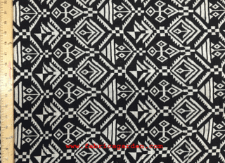

Step 1: Materials and Tools
Materials
1. Non-conductive fabric: can be any sort of standard non-conductive fabric, very small piece is needed therefore I would look for some old clothing or some fabric left-overs.
