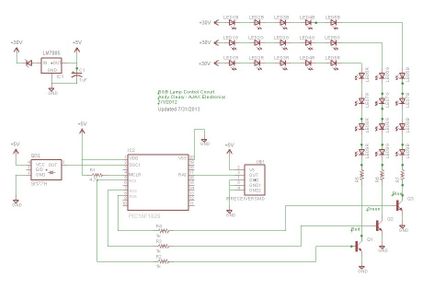

Step 3: Control Circuitry
Circuit Details:
The control circuitry is about as simple and it gets (See the attached schematic). There is a PIC 16F1829 microcontroller with three PWM outputs, and each output uses a bipolar transistor driver and current limiting resistor to interface to the LED strings. If you're looking for more electrical efficiency, you could try using a specialized LED control IC like the ZXLD1350.
I opted to run each LED string in series for ease of wiring, ease of control, and greater efficiency (only one current limiting resistor for 9 LEDs). You do give up some freedom, since now you can only control each color channel instead of each LED individually.
I used a crystal oscillator to provide the microcontroller clock because a) I had one laying around, and b) I wanted to make sure I had accurate timing for the remote control decoding. There is an internal oscillator in the PIC 16F1829 that you could potentially use to reduce parts count.
The IR detector/decoder is one I found in the parts bin. You could use any type of IR detector, but I like the can type since they have built-in filters and amplification.

I assembled the final circuit on perfboard (See picture in step 6).
