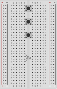

Step 2: Add RGB LED
The RGB LED will have four legs, the longest leg is the cathode. Put the cathode on e20 on the breadboard, and the rest as shown above:
  1. Top on e19
  2. Second/Cathode on e20
  3. Third on e21
  4. Fourth on e22
The other legs are red, green and blue respectively.

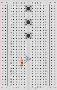

Step 3: Add Resistor
Add the resistor from the second leg (cathode) from d20 to d24.

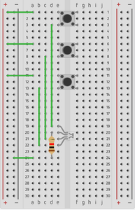

Step 4: Wire Everything Up
Connect the wires as shown above, or follow these steps:
  1. a1 to positive rail, usually marked with a '+' (does not matter where on the rail)
  2. a6 to positive rail
  3. a11 to positive rail
  4. a24 to negative rail
  5. d3 to d19
  6. c8 to c21
  7. b13 to b22
Step 5: Connect 9V Battery
Apply the battery clip and connect the positive wire, usually red, to the positive rail marked with a '+'. Then connect the negative, usually black, to the negative rail marked with a '-'. It does not matter wher on the rail you connect the wires.
Step 6: We're Done!
Experiment by pressing each button and seeing which color the LED lights up. You can even try to hold multiple down together to make different colors. A guide to this is shown below.
