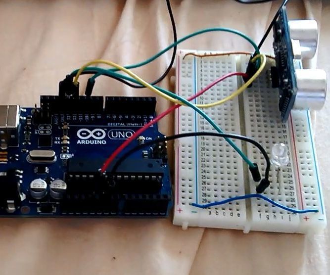

Step 1: Materials and Connections Diagram
For doing this controller you will need the following things:
- Arduino UNO Board.
- Common catode RGB LED x 1.
- Protoboard.
- Push Button normally open x 1.
- 10K Resistor x 1.
- 220 ohms Resistors x 3.
When you have all of the materials just follow the connections diagram posted here.
Step 2: Uploading the Code to Your Arduino!!
When you are done with the hardware connections, just plug your Arduino board to your PC with the USB cable, and upload the sketch that you can download in the link below:
http://www.mediafire.com/file/cblzd828wgwdllk/Control_RGB_Psh_Buton.rar
Once you have done this, your RGB led should be shining in blue. Yayy!!!
