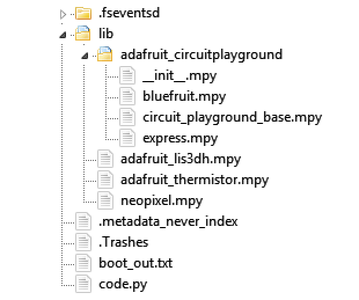

Step 1: Installing CircuitPython and CPB Pixel Current Program
If you are not familiar with CircuitPython then it's worth reading the Welcome to CircuitPython guide first.
- Install the latest version of CircuitPython (7.3.3 in September 2022) from https://circuitpython.org/ - this process is described in Adafruit Circuit Playground Bluefruit: Install or Update CircuitPython.
- Verify the installation by connecting to the serial console over USB. The REPL prompt shows the version. The version can also be checked by inspecting boot_out.txt on the CIRCUITPY drive.
- Install these libraries from a bundle from https://circuitpython.org/libraries into the lib directory on CIRCUITPY:
- adafruit_circuitplayground
- adafruit_lis3dh.mpy
- adafruit_thermistor.mpy
- neopixel.mpy
- Download the NeoPixel sequencing program to CIRCUITPY by clicking Save link as... on cpx-pixel-current.py
- Rename or delete any existing code.py file on CIRCUITPY, then rename the cpx-pixel-current.py to code.py. This file is run when the CircuitPython interpreter starts or reloads.
The versions used for this guide were:
- CircuitPython 7.3.2
- CircuitPython library bundle adafruit-circuitpython-bundle-7.x-mpy-20220827.zip

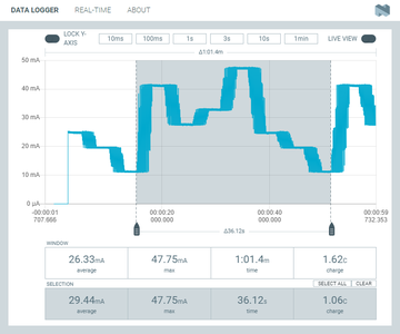

Step 4: Rainbow Unicorn Power Profiling
This video looks at the power consumption during the colour cycles of the Rainbow Unicorn intended for use with a CR2032 battery. The variable voltage feature of the PPK2's power supply is used to explore the behaviour at different voltages. The 3V represents a typical value for a new battery under load. The 2V is a voltage sometimes cited as the final voltage for a fully discharged CR2032.
- 00:04 Start is pressed to start the data logging, graph shows noisy 0.25uA value.
- 00:05 The power output is enabled at 3.005V. The unicorn starts with all four LEDs showing red (appears as orange in the video).
- 00:08 Red at 26mA transitions to green at 20mA then blue at 12mA.
- 00:20 (Greenish) yellow at 43mA, cyan at 29mA, magenta at 34mA, (almost) white at 50mA.
- 01:07 Repeat of the colour cycle at an abnormally low voltage of 2.06V. The red LED is the only one that works at this low voltage with lower current consumption at 6mA. These LEDs are clearly not designed to work at this voltage.
The four LEDs on the Rainbow Unicorn start with synchronised colour cycles but quickly drift out of synchronisation.
Step 5: Calculation of Battery Lifetime
The Nordic Power Profiler software presents statistics for the current window of data and for any selection. One cycle of the colour changes for the Rainbow Unicorn is shown above with an average current of 29.44mA and a peak of 47.75mA. The CR2032 batteries use a lithium/manganese dioxide cell with a nominal voltage of 3V and a capacity around 225mAH. The battery lifetime would be expected to be around 225mAH / 29.44mA = 7.6 hours.
A battery data sheet from a reputable manufacturer would provide a more detailed account of how the lifetime varies with current. The voltage for a discharging battery is not constant and the lower voltage towards the end of the battery lifetime may be below the minimum voltage for the device further reducing the practical battery lifetime.
