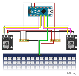

To test everything worked, I first built the circuit using a breadboard. The matrix should use an additional power source, however I did not have any problems using power directly from the Arduino -- but do this at your own risk!

Step 4: Bringing It All Together
Now it's time to put the components into the case!
To keep the device as slim as possible, I used thin strips of protoboard (1 x 4) to distribute +5v and Ground and soldered connectors to them.
The rotary encoders came with nuts to screw them to the case. Everything else is held in place using hot glue.
Note: if you are building your Etch-A-Sketch using the final photo, remember that you are looking at the rotary encoders from the back. On the schematic (Step 1), the rotaries are shown facing forward.
Enjoy creating your pixel art!
