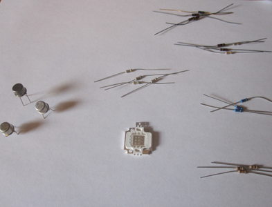

Step 1: Overview of Circuit Components
Other than basic wire (and the LED) our circuit has two main components: transistors and resistors.
Transistors
So we have a 10W LED, power cable, and arduino. The goal is to wire the LED to the breadboard and attach the arduino to the same breadboard so that the arduino can output a value and the LED will turn on at a certain brightness (corresponding to the value the arduino outputed). The issue is, the arduino can only supply 5V, but our LED needs 12V (note: this may change depending on what power LED you're using) . This is where the power supply comes in.
"How will we ever connect the arduino, LED, and power supply together?!" you might ask.
The answer is magic. The magic of TRANSISTORS!

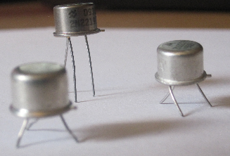

Simplistically, a transistor is an amplifier or a switch. In this case we're using it as a switch. It'll be connected at one pin to the arduino, another pin to the power supply, and a third to the LED. When the arduino sends a current over a specific threshold the transistor will 'turn on' and let the power supply voltage run through it, lighting the LED. When there's not enough current from the arduino, the transistor won't let the power supply run through it and the LED will be off.
The switching type of transistor is known as a switching or junction transistor. There are many different types available which have different properties like voltage needed across its pins, the gain, etc. I encourage anyone interested to read more about transistors to get a much better understanding of them.

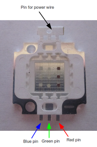

The 10W LED has four pins total, on one side the ground and on the other side a pin for each color. If we want to be able to control each color separately (in order to be able to display any color combination of RGB), each color must have its own transistor, so we need three transistors total. More details on the transistors used will be in the next step.
Resistors
Now that we've figured out how to power up the LED, there's another problem. All this power isn't necessarily a good thing! We don't want to short out the LED, so resistors need to be added to it.
Of the four pins on the LED, the ground pin doesn't need a resistor since it's just going to ground. But the three color pins will need at least one resistor, and since different colors draw different voltages they aren't necessarily the same resistances.
"How will we ever figure out these values?!" you might ask.
Well the answer is MAGIC. The magic of MATHEMATICS! (read on it's worth it I promise...)
Step 2: Calculating Circuit Components
Transistors type
As said in the previous step, the transistors used here are of the switching variety. What specific type of transistor is needed in a circuit depends on what the circuit requires, but in this circuit a 2N2219 transistor is suitable. Note, you can use a transistor other than 2N2219, as long as it has the right specifications for the circuit you're working on. (The more common 2N2222 transistor should also be suitable)
Depending on the transistor type, the three pins on the transistor will be either "emitter, base, collector" or "gate, source, drain." The 2N2219 type is the former. There are many transistor body types, so in order to determine which pin corresponds to the emitter, base, and collector, it'll be time to consult your spec sheet!

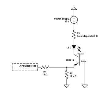

The transistor also needs two resistors. One connects the base of the transistor to the arduino - this can be any value, generally around 1kΩ. This is used so that any spurious current from the arduino won't cause the transistor to trigger and accidentally turn the light on. The second resistor needed connects the base to ground and is generally a large value like 10kΩ

Summary of required circuit components:
3 x 2N2219 transistors
3 x 1kΩ resistors
3 x 10 kΩ resistors
Red: 4 x 68Ω 1/4 W resistors
Blue: 4 x 27Ω 1/4W resistors
Green: 4 x 27 Ω 1/4W resistors

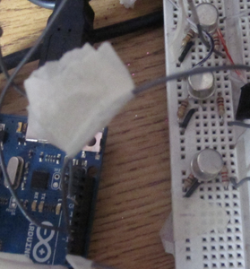

Step 3: Circuit Schematic / Constructing the Circuit
Having gone through the math and collected all the required pieces it's time to put them together!
First take your power supply and cut off whatever connection it has at the end and isolate the power and ground wires. Add the ground wire to one of the breadboard rails. Solder the power wire to the solder the necessary resistors onto the LED. Then build the circuit like indicated on the circuit diagram.
Note that all the grounds in the circuit (arduino ground, transistor grounds, power supply grounds), must be connected together in some way.

Step 5: Adding the Fiber Optic Wires

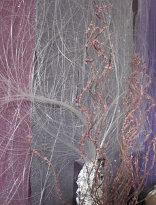

Even if you don't complete this step, the nice thing is that now we have an awesome, bright, fully customizable RGB LED. I chose to combine it with fiber optics, but really you can do anything you want! Make a sweet spotlight? Light a disco ball? So many possibilities!
I originally purchased five feet of 50 strand fiber, 10 feet of 12 strand fiber, and 5 feet of 25 strand fiber. I ended up cutting the length in half so that I'd have more spots even though the wires themselves were shorter.
I chose to make a tree since I couldn't mount them through a wall. The tulle was glued on the wall via rubber cement (tulle is fairly lightweight, so tape might be sufficient). The fibers are thread through the tulle into a tree like pattern.

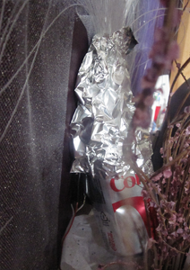

Using an empty/dried out soda can the LED is placed at the bottom, and the fibers are added to the top of it.
The biggest issue at this point is trying to make sure light goes through the fibers instead of just out through the top of the soda can. Wrapping the fibers tightly in foil can help, but I suggest trying out whatever setup you think might work.
Put all these pieces together and we have our tree!
