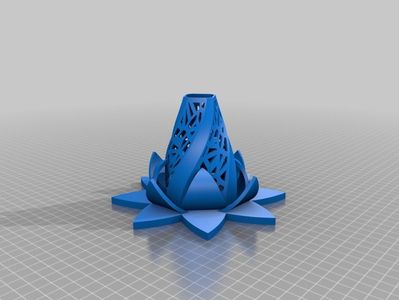

The choice of what to put the LED in is up to you, I personally used the Radiant Blossom model by areynolds15 on Thingiverse. I recommend using white filament using a low fill density to allow the light to pass through easily, although more exotic filament might produce even more interesting looking results.
