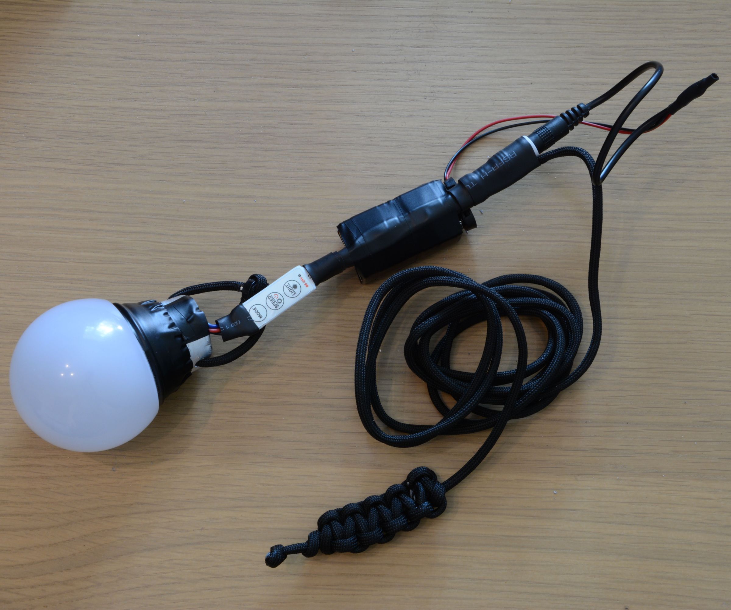

Introduction: RGB LED Light Writing Wand
Following on from my previous instructable, I have an interest in long exposure photography. The tools to do this tend to be on the pricey side, so I decided to make a couple of my own.
NOTE: I wanted RGB and white, however the chip will not light up white (RGB at the same time). I believe it to be because of one of 2 reasons; 1. The chip does not accept 3 channels of current at once. or 2. The 9v provided is not enough forward voltage to power all 3 channels at once. The pictures in this instructable will show 4 buttons, however I shall disregard the white button and only refer to 3 (RGB). I could add another battery, such as 1.5v aaa/aa in series with the white button to boost the voltage only when the white button is pressed. However as I did not test until the end of the soldering process, I had already cut my PVC pipe too short to allow additions.
This wand is designed to give the user easy control of colour whilst in use, without having multiple tools or heads to change.
A total of six colours can be achieved using single or a combination of two buttons.

Step 4: Break Down Household Bulb
The reason the bulb is required is purely for the diffuser and the heatsink contained inside. There are most likely alternatives for these items however I could not find/think of any at the time.
To break this down I used small flat screwdrivers and pliers. Prising the metal cap from the base, removing the inner electronics and diffuser (be careful not to damage) and outer plastic casing. I also tried using a rotary tool with cutting blade to allow the diffuser to come loose, however I only found it useful for starting to get a lip to get the screwdriver under.
This should leave you with a metal heatsink with LEDs attached and the plastic diffuser. Remove the LEDs from the heatsink via the two screws and clean the top from thermal compound. This is now the main base to build onto.
At this point, the heatsink I had had 3 holes; 2 small for screws and a larger on in-between. I decided to drill a hole opposite the larger hole and use these as cable channels, with the larger one being for R G B -ve and the smaller for +ve.
