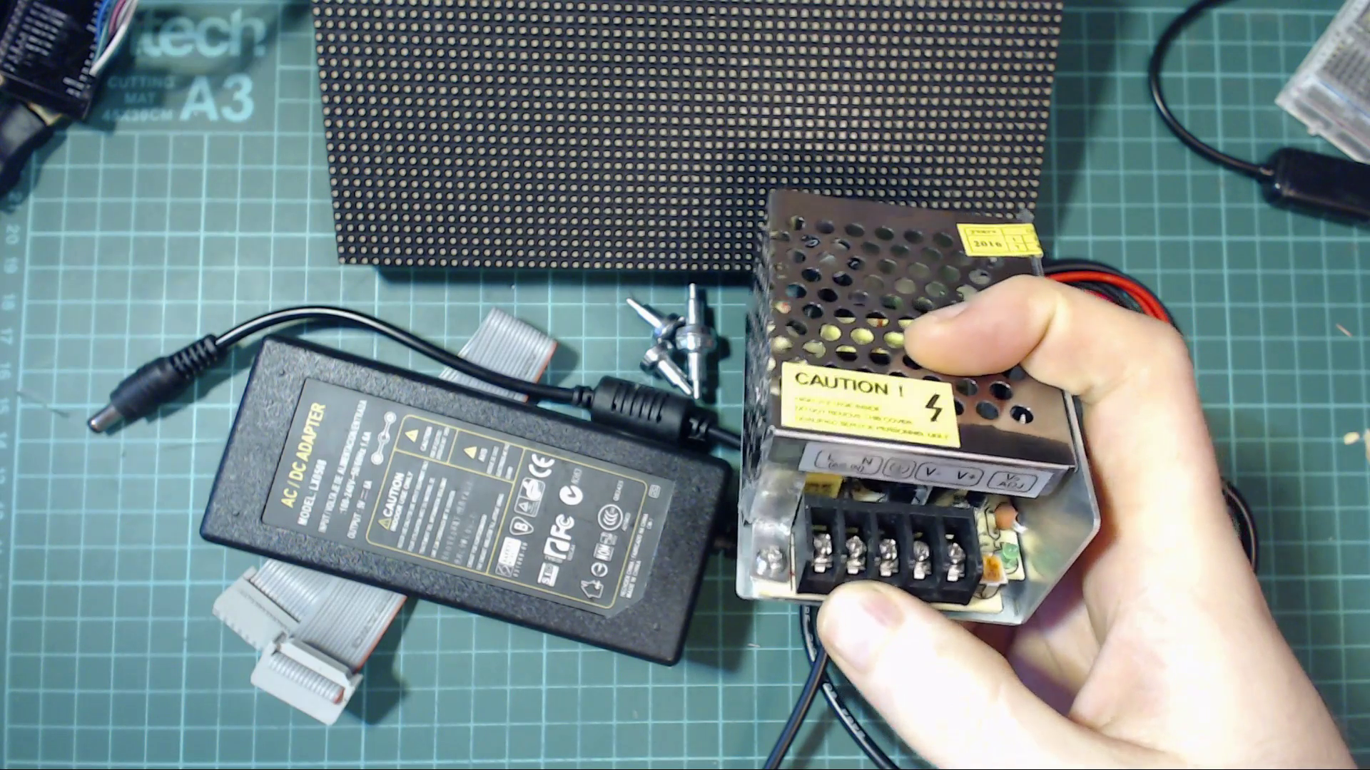

The first thing we'll need is a pretty large 5v power supply, Adafruit suggest that 64x32 matrix can require up the 8 Amps! This is worst case scenario (all LEDs set to white) so in reality you probably won't need one that big, but there is no harm in having the head room. There are two different types of power supplies that you can get:
Types of PSUs - Laptop style on the left
One is similar to a laptop and has a 2.1mm jack as its output and there other is more similar to type that comes with 3d printers.
I much prefer the laptop style as the other requires you to connect mains voltage wires to it, and working with mains voltage is something I like to avoid as often as possible! Here is a link to the same type of one I used (5v 8 amp laptop style)

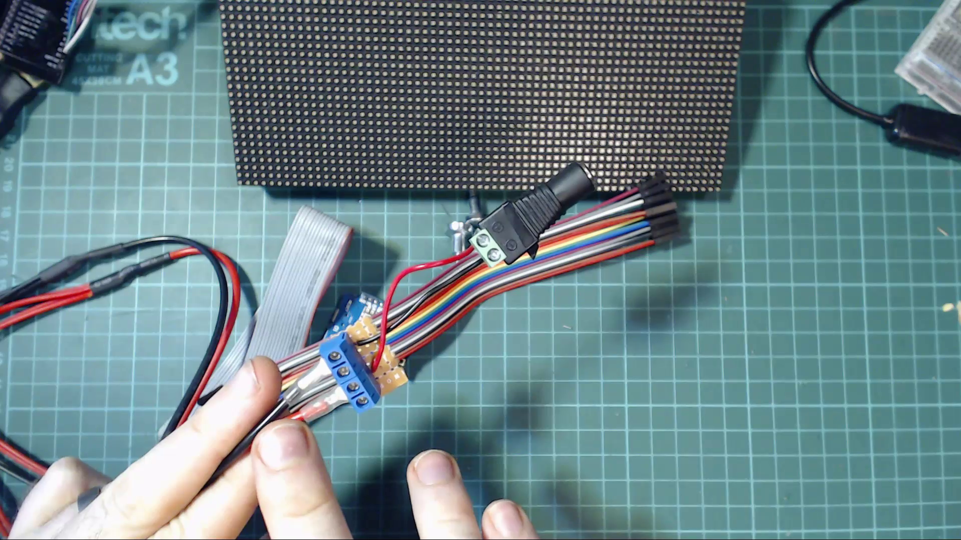

Connecting Up The Power Supply

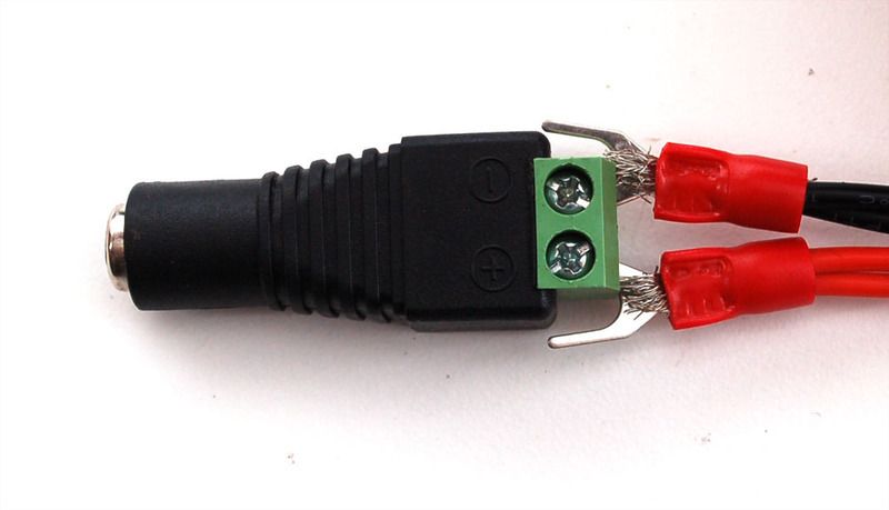

First thing we need to do is connect the power supply up to the wires that came with the display.
The Adafruit learn guide recommends connecting up the wires like this:
I couldn't get this to make a solid connection (physically), but who am I to question what Adafruit suggest! If you do go down this route make sure to use some insulating tape or heatskrink to give it some strength.
I ended up using a couple of screw terminals and piece of perfboard to make a small board for connecting the power supply to the wires, I was happy with how it turned out!

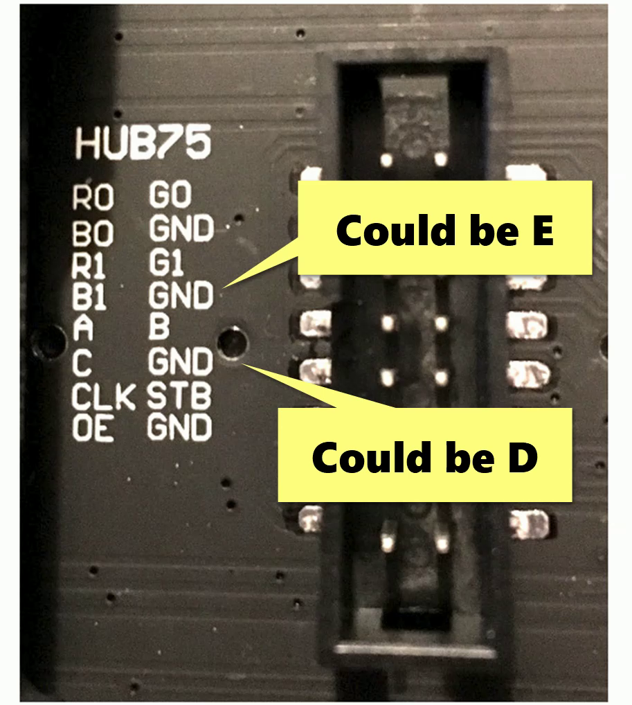

Connecting Up The Data Wires
Next we'll hook up the the data wires for the display. The library github lists a couple of different pin layout examples, but only the labels seem to change between the different ones and mine didn't have any labels at all! I wired the board as follows:
You'll notice on the back of the display that there are two connectors, the one you want to wire to is the one where the arrows are moving away from it
Some of the pins are not needed depending on what display you have, these are the C, D and E pins. The library lists instructions for when you need to connect up these pins based on the scan rate of your display:
Display Pin | ESP8266 Pin | Note |
C | 15 (D8) | Only for 1/8, 1/16, 1/32 scan |
D | 12 (D6) | Only for 1/16, 1/32 scan |
E | 0 (D3) | Only for 1/32 scan |

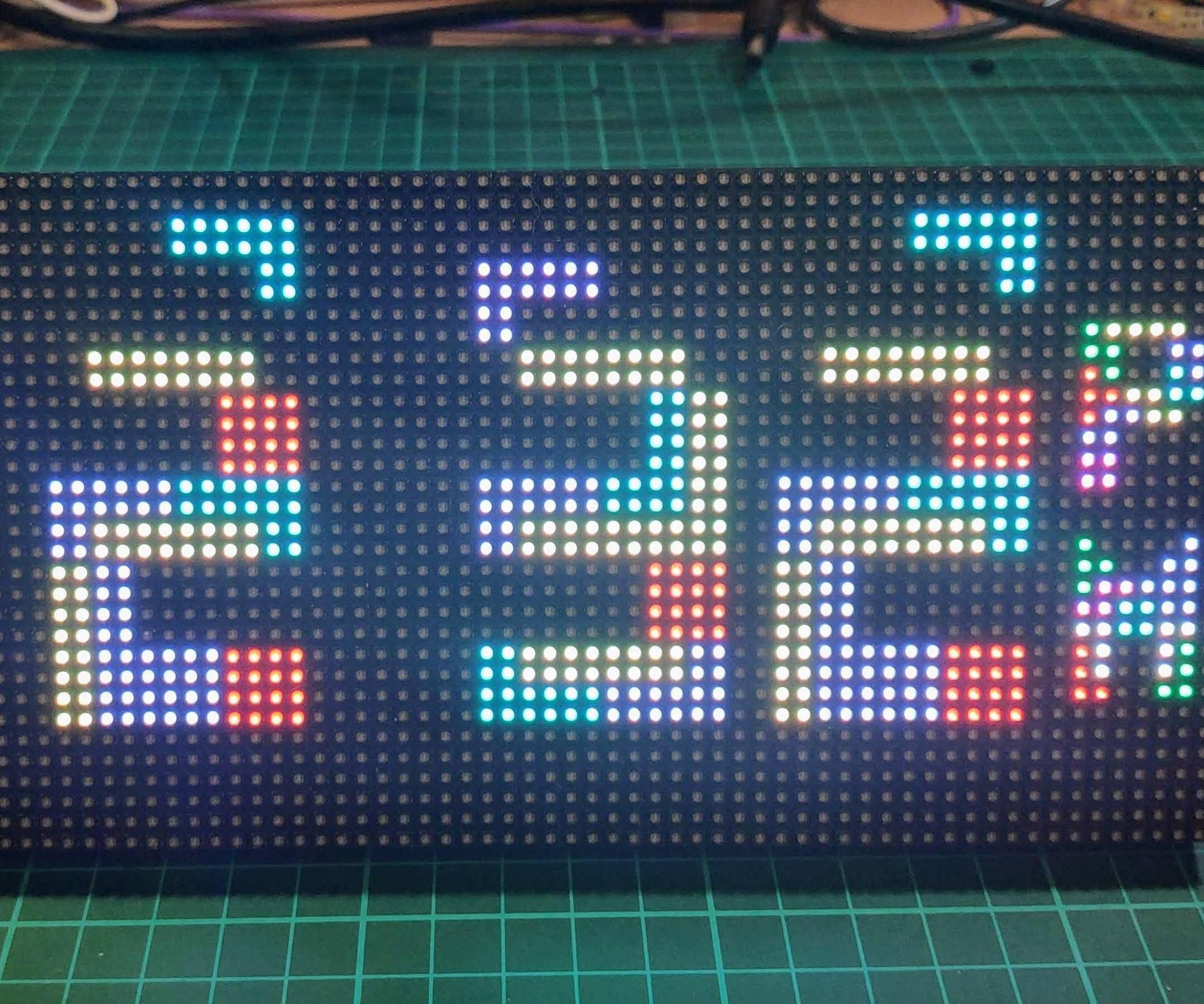

Although my display is a 1/16 display and I needed to for E connected up. This is what it looked like without it:
The best way to check if they are required for your display is they seem to be connected to ground on displays where they are not needed. Get your multimeter in continuity mode and check these pins against the ground pin, if the pin is connected to ground you don't need it

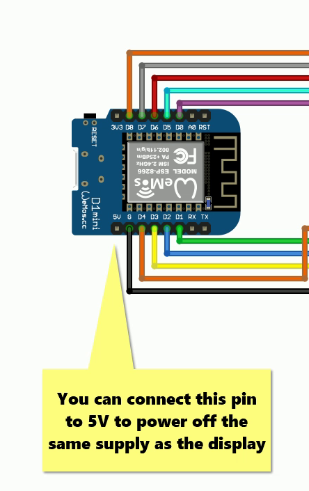

It is also possible to power the ESP8266 off the same power supply as the display, but the simplest and safest way is to power them separately.
If you do want to power off the same supply, on the Wemos D1 mini board we can connect the 5v of the display power supply directly to the 5v pin. Two things to be careful about:
- If you plug in just the USB and not the larger power supply then display will try run off the USB power and it could cause overload your USB supply. You could fix this by putting a diode between the display power supply and 5v pin (so current can only flow towards the esp8266)
- If you are not using an Wemos D1 mini make sure whatever pin you are connecting to has a voltage regulator connected to it (Don't connect directly to the 3.3v pin!)
One other note. If you are using a ESP8266 that doesn't use pins labeled with a "D" in front of it (e.g. D1, D2 etc) you can use the following Diagram to map the pins to the ESP pins. For Example D1 is connected to GPIO pin 5, so if your board uses the GPIO pin numbers connect that connection to 5.

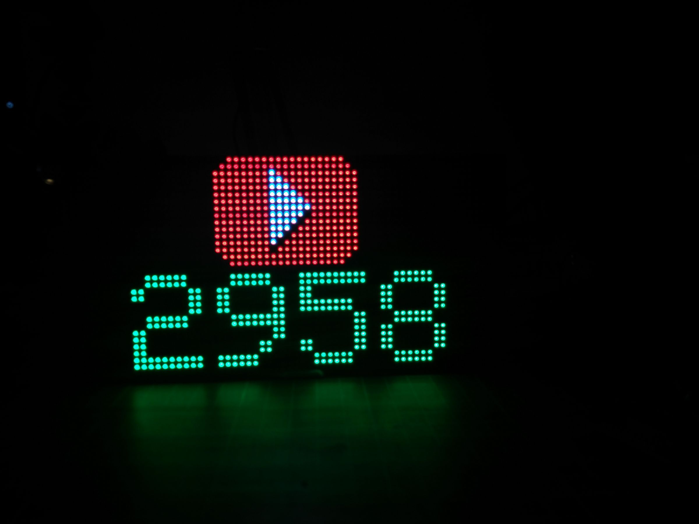

The last example is a more dynamic one, it uses my YouTube API library to display your live YouTube subscriber count on screen. Code for this example can be found here:
https://github.com/witnessmenow/LED-Matrix-YouTube...
