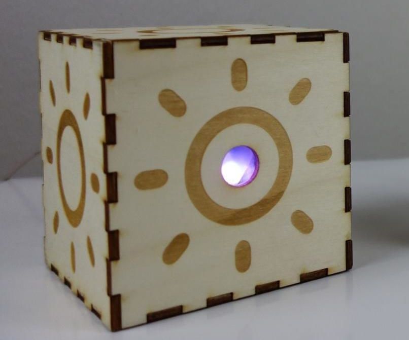

Have you ever wanted custom illuminated and controllable small RGB lamps? Well at least I did and that's why in this tutorial I'll explain how to reproduce this one which is pretty easy & quick to make, the longest part being waiting for your 3D printer to finish the plastic parts :)

Step 3: Soldering the LED Ring
Now it's time time to prepare the LED ring and for this you simply need to either solder the wires you'll want to use or a JST socket like on the picture.
The pins you need to solder are these ones:
- DI: It's the input data pin you need to connect to your microcontroller board to control the LED colors
- 5V: The 5V (or positive) wire of your DC power supply (I recommend you at least a 0.8A/800mA one if you use a USB charger)
- GND: The ground (or negative) wire of your DC power supply
The DO (Data Output) pin is only used if you want to daisy chain multiple LED rings/strips or else you can let it unsoldered.

Step 6: Connecting the Microcontroller Board
Now it's time to connect the lamp on your microcontroller board.
If you're using a NodeMCU ESP-12 (based on a ESP8266) board you'll have to do the following connections:
- DI (LED ring) -> D7 (NodeMCU)
- 5V (LED ring) -> VV (NodeMCU but more commonly named 5V on other boards)
- GND (LED ring) -> G (NodeMCU)
Step 7: Flash a Sketch and Enjoy!
Everything's assembled and connected? Means it's time to add the final touch and flash our board with a sketch to control our LEDs and we're done! =)
There're plenty of them on the Internet as the WS2812B LEDs are very popular, personnally for this example I adapted the ColorPalette example (attached to this step) from the FastLED library for this specific board and LED ring so you can just copy & past it directly to upload from the Arduino IDE for this board and you can enjoy the animation!
Here we are, hope you enjoyed this =)
