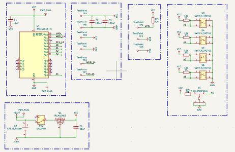

ATTINY1616, the chip! - $0.90 USD
0.1uF and a 10uF 0603 ceramic capacitor, power filtering - $0.16 USD
6 10k resistors 0603, pull ups - $0.60 USD
4 6.00mmx6.00mm buttons - $0.48 USD
1 Surface Mount button - $0.48 USD
1 P-Channel MOSFET, battery protection - $0.42 USD
1 Power Switch - $0.72 USD
1 CR123A Battery Case - $2.25 USD

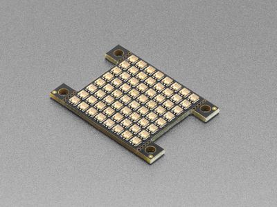

1 Adafruit DotStar High Density 8x8 Grid, - $25 USD. Yep $25 clams… These are awesome matrices that will save a lot of work but at a cost. With a hot plate, you can also remove them and reuse them for another project. I do plan on trying to build my own multicolored, lower-power, cheaper LED matrices. Look out for that in future builds.

This project is a good example of a bare chip that is powerful and easy to program. This final board will have five buttons, four for gameplay and one to switch between games.
You can order the board here. Make sure to get the stencil as well. Or design it with a bread board.
This blank chip can be programmed using a UPDI programmer in the Arduino IDE environment. Follow the excellent steps provided by Adafruit.
On the back of this board, there are three pads: Vin, Gnd, and UPDI programmer. I solder three separate male headers onto these pads. I use clay to help align the headers when I solder. Look at the pics above. Soldering and Assembly step below for more detailed build instructions.

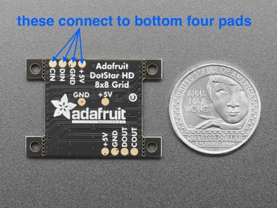

  1. After the board can be programmed (see above step), it’s time for the LED matrix. I broke off the side tabs of the LED matrix and put a little solder on the board’s blank pads. When looking at the front of the board and going left to right, the pads are: SCK (clock), MOSI (data in), GND, and VIN. I designed the board so these pads align nicely with Adafruit’s matrix.
  1. **Make sure you use the matrix's data in and clock in pads with the board's MOSI and SCK**. I think if you use data out and clock out, it won’t work.
  1. Place the matrix on the pads with solder and back to the hot plate. Take off at around 215°C.
