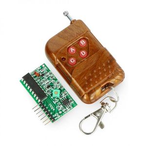

  • 433 MHz RF module
  • Visuino program: Download Visuino
Step 2: The Circuit
  • Connect Remote pin [VCC] to Arduino pin [5V]
  • Connect Remote pin [GND] to Arduino pin [GND]
  • Connect Remote pin [D0] to Arduino digital pin [4]
  • Connect Remote pin [D1] to Arduino digital pin [5]

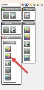

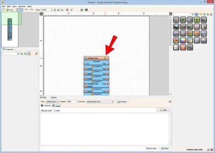

Step 3: Start Visuino, and Select the Arduino UNO Board Type
The Visuino: https://www.visuino.eu also needs to be installed. Download Free version or register for a Free Trial.
Start Visuino as shown in the first picture Click on the "Tools" button on the Arduino component (Picture 1) in Visuino When the dialog appears, select "Arduino UNO" as shown on Picture 2
Step 4: In Visuino Add,Set & Connect Components
  • Add "Random Color" component
  • Add "Color Value" component
  • Add "Color Multi-Source Merger" component
  • Add "RGB LED" component
  • Connect Arduino digital Out pin[4] to "ColorValue1" pin [Clock] , this will be used to turn the LED Off
  • Connect Arduino digital Out pin[5] to "RandomColor1" pin [Clock] , this will be used to set the random color on the LED
  • Connect "RandomColor1" pin [Out] to "ColorMultiMerger1" pin [0]
  • Connect "ColorValue1" pin [Out] to "ColorMultiMerger1" pin [1]
  • Connect "ColorMultiMerger1" pin [Out] to "LED1" pin [In]
  • Connect "LED1" pin[Red] to Arduino Digital-Analog PWM pin[6]
  • Connect "LED1" pin[Green] to Arduino Digital-Analog PWM pin[10]
  • Connect "LED1" pin[Blue] to Arduino Digital-Analog PWM pin[9]
Note
: If the LED is not shining then Select "LED1" and in the properties window set "Inverted" to True

If you power the Arduino module, and press the button "A" on the Remote the LED will Turn ON and a random color will shine, If you press the button "B" on the Remote the LED will turn off.
