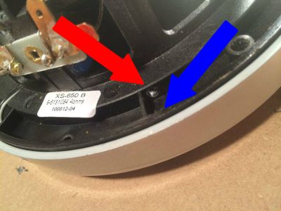

Drill a 3/16" hole just to the right of the speaker terminals. (This is the red arrow)
- The best placement is about 1/4" off of the rib of speaker shown between speaker terminal and red arrow
The blue arrow shows the tweeters speaker wire.

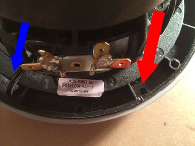

Drill another 3/16" hole directly in line with the first hole but on the ridge of the plastic housing.
The red arrow represents the new hole on the ridge.
The blue arrow shows where the first hole you drilled would be located however, The angle of the picture does not show the hole drilled from step 1.

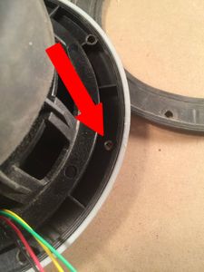

Remove the 4 screws that were covered up by the black rubber ring
- Use a #1 bit phillips drive to avoid stripping out the heads of the screws
- Do not lose the screws, keep in a safe place.

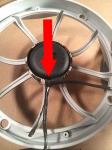

In the photo above take note of the Tweeter speaker cable marked by the red arrow.
Step 4...
Flip the speaker over and carefully remove the speaker grill.
- the speaker grill is not siliconed in so it should just pop right off
Step 5...
The tweeter speaker cable is glued to the plastic grill, you will need to release the hold of the glue, just use your fingers and apply pressure, pops right out.
