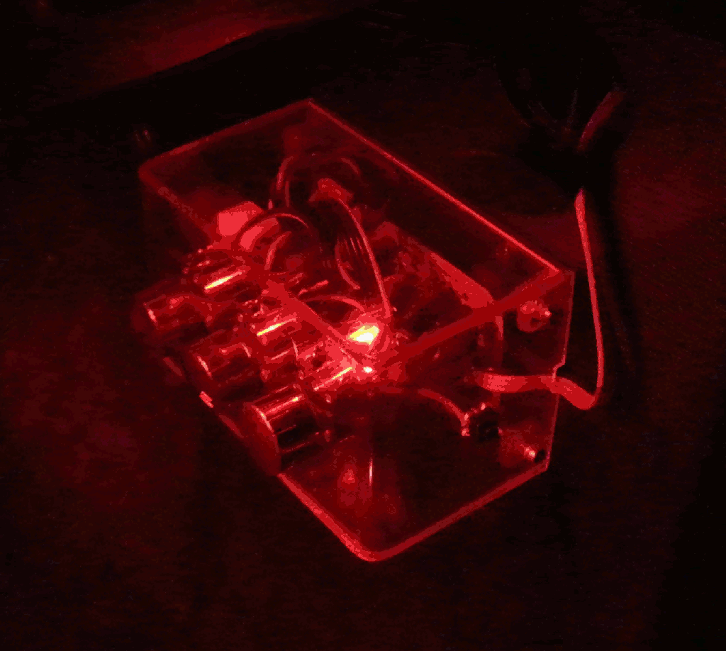

This is a remote-controlled multicolour LED-Strip controller box I made for a friend. We planned to install subtle lighting inside his car for which we got a tiny controller box + remote with the multicolour LED Strips. Unluckily, we couldn't open the door panels for wiring and had to take aid from professionals. While installing the strips, they probably shorted something (they did really shabby wiring) and all the magic smoke from controller box escaped. The lack of any protection circuitry in the controller box didn't help much.
So we were left with a functional but useless remote and LED strips directly connected to power, and so limited to being manually-wired to one of the 6 basic colours(red, green, blue, yellow, cyan and magenta). So it was time to make a better pimped-up RGB LED Strip controller box!
This was finished and installed 2 days before the Indian festival of lights: Diwali. Christmas is also round the bend and this could be put to use for christmas tree lighting. Christmas carol synched lighting anyone?
Here is a video of it in action. I forgot to show the clap-on function. Maybe a smaller video later... The amplifier gain sensitivity for audio is turned down so only the strong bass beats are picked up. Amplifier gain can also be turned up to even pick up normal human voice.

Step 10: Finished: Assembling Controller Box
To assemble, the top part of enclosure is put on top of the base and holes drilled in the sides aligned with the vertical nut holds. File a notch in the enclosure’s top part’s side so the LED Strip ribbon connector can come out.
Attach the PCB to base with screws. Attach potentiometers to enclosure top, tighten with nuts and add knobs.
Connect the power connectors to ArrDrownHo! and JST socket, the microphone and button connectors to their respective female headers.
Note: While connecting power to ArrDrownHo!, make sure of the orientation as shown in image notes. I later added a white stripe to both male and female header's 12V side to mark the orientaion.
Screw the base to the top and you're done!
