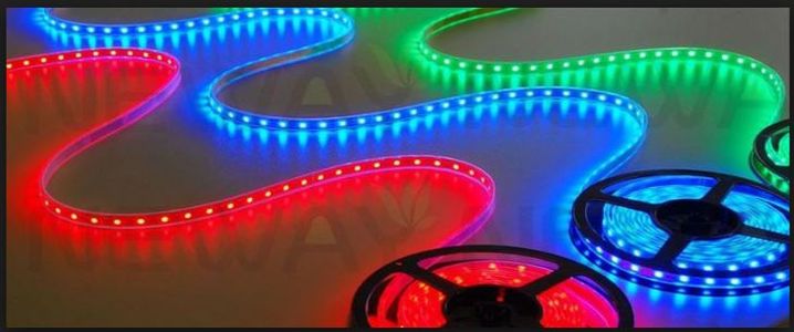

Introduction: RGB LED Strip Light Control
Hello guys!
I decided to do a cool project on controlling your RGB LED strip by using a simple application that you can download from the google app store. I've seen many tutorials using the Arduino Leonardo and a RGB LED strip to display a cool light show using music to sync with the LED s. However, I decided to write a code a simple code that will be able to control the color on the LED s, the dimming effect on the color you decide to dim, and the speed of the dimming on the LED s.
Here is a little demo on the project:
So I hope you guys enjoy my small project and lets get started!
