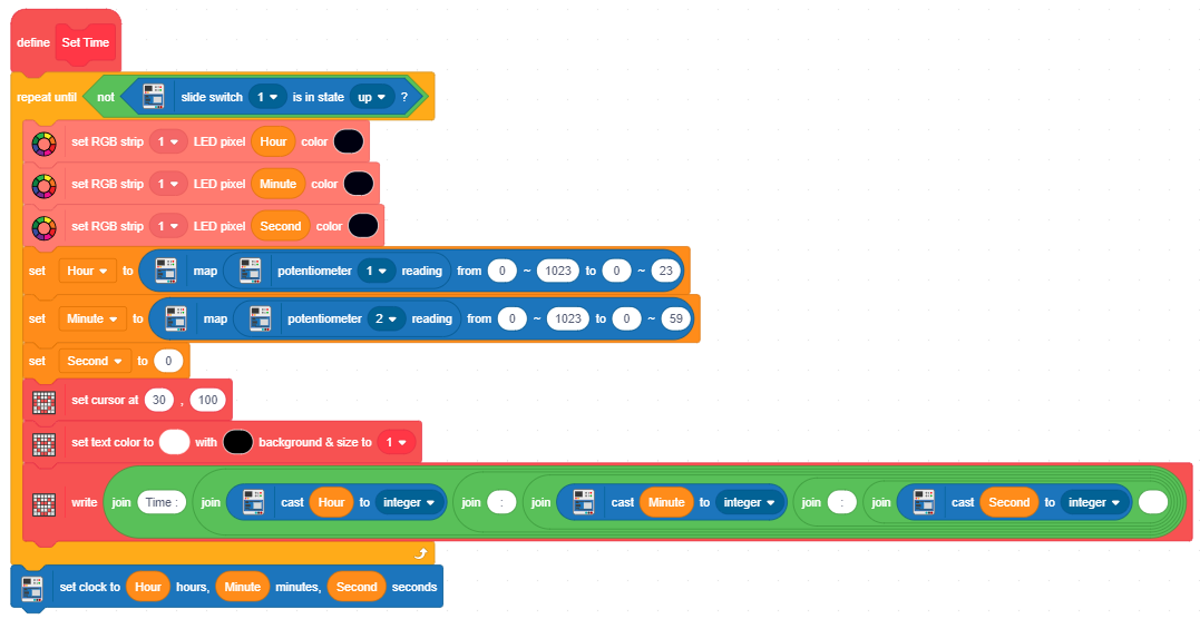

Step 9: Setting Time and Date
There is an inbuilt RTC in evive. But before using it, we need to initialize it. Follow the following steps:
Time:
To change the time slide the Slide switch 1 upwards.
- Potentiometer 1 to set the hour.
- Potentiometer 2 to set the minutes.
Date:
To change the date slide the Slide switch 1 downwards.
- Potentiometer 1 to set the date
- Potentiometer 2 to set the month
- Tactile switch 1 to increase the year count by 1
- Tactile switch 2 to decrease the year count by 1
Step 10: Coding the Wall Clock
We are going to code our clock in a simple way that is using PictoBlox– a graphical programming software. Either write the following script in PictoBlox or directly download and upload the code to evive from the code section:
The first block is the initialization block, that initializes the RGB as well the TFT Display.
The below two blocks “Set Time” and “Set Date” are used to set the time and date in RTC which is found inbuilt in evive. We need to set the time and date using potentiometers and tactile switch of evive.
