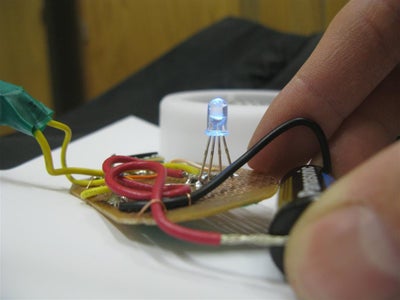

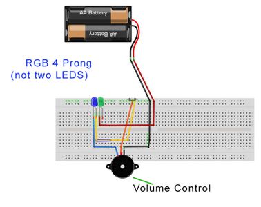

Step 1: Breadboard Setup, Experiment at Will
Wiring it all up
The steps are quite simple, wire it all up and this will product a blue / green when the button is pushed, you can also take the xtra button from the other light and add an on/off switch before the connection to the battery.
Volume Control
They are different in each type of electronics and i am not an expert on them, however i do know if you are able to find one with 5 metal prongs on them instead of the three prong that is used here, you can use it to fade to different RBG colors, it takes some experimenting but i have tried it you can fade from purple to red to blue to green etc, depending on how your wire setup is, however i soldered to close to the 5 prong volume control i had and messed up the prongs, so i moved onto the next one i found.

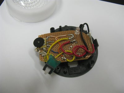

Step 2: Solder the Final Product
What not to do
As i mentioned on the previous step, don't solder to close to each prong, as you may end up ruining it.
You may notice a metal bracket hanging off the edge of the PCB this was to add xtra support to the volume control, as it needs to be over the edge to fit through the slit in the side of the plastic light to be adjusted. With the three prong volume control it only dims the light.

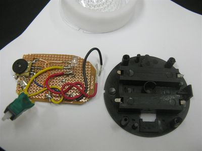

Step 3: Fitting It All in There
Well its difficult, and you will have to cut a slit for the controls to be used on the outside.
