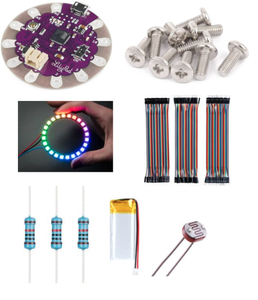

Step 1: Gathering Materials and Tools

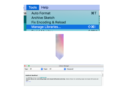

Step 9: Download the NeoPixel Library
Open Arduino, go to Tools > Manage Libraries and search up "neopixel" in the search bar.
Download the library that says "Adafruit Neopixel".
