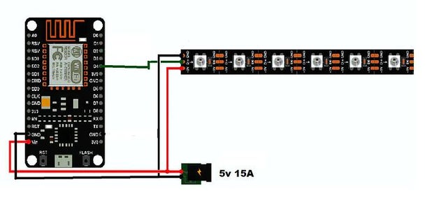

Step 2: Wire Your Controller
First a little theory.
The WS2812B is an RGB LED in the SMD 5050 case with WS2811 controller already integrated.
The ESP8266 is a system on a chip (SOC) Wi-Fi microchip for Internet of Things (IoT) applications produced by Espressif Systems.
We need either to power it via the usb connector or supply it with a 5v from a LiPo battery and a buck convertor.
I won't go into details here. You can find lots of tutorials on the internet (including this one here https://www.instructables.com/ESP8266-controlling-Neopixel-LEDs-using-Arduino-ID/)
