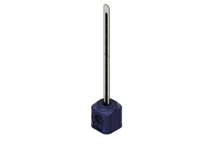

Designed in Fusion360 and also I provided the Fusion360 file so that you can edit it according to your requirement.

Step 1: Design in Fusion360 and Download Fusion360 Design File (Version:2 Lamp)
If you want make same as this Lamp then go for this Version:2 or Edit Fusion360 File according to needs.
