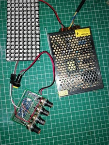

I have seen WS2812 256 LED programmable matrixes sold for as much as 70 GBP which makes me baulk! But a bit of research and some special offers on Ebay (other sources are available) had myself and my partner ordering one each on top of the one I already had sourced and tested some simple programs on. Now these are generally designed to have patterns, words and graphics displayed on them and I did buy a 8 GBP controller which can operate form a mobile phone and made some pretty patterns on one. I had heard a few people say that you should not run these 100% on all LEDs and it is also mentioned that the LEDs can become de-flowed, that is desoldered. Well you have been warned and the hobbyist is likely to be capable or soldering a few joints in the even of a problem. I think this will put out 5 Volts x 7 Amps = 35 Watts. Probably equivalent to 150 watts of incandescent lighting but with RGB control!
As for cooling I will be installing a PC cooling fan in each box. I reckon they consume 6.7 amps when fully on. You will need substantial wire from the 5V power supply to the LEDs as I managed to almost melt mine when trying to drive 3 LED matrixes at once!

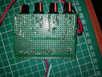

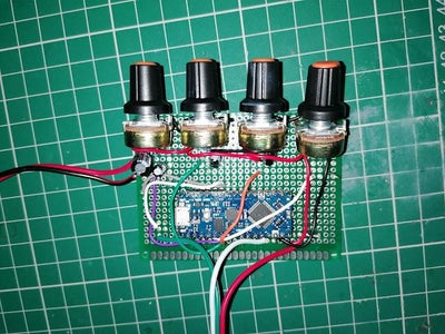

The circuit was proved using an Arduino UNO on breadboard and I initially mounted the controls and resistors on prototyping board, even though this was only a half sheet i knew I had enough space for an Arduino Nano or Arduino Every. The Every is pin compatible and available in three packs, well I did want to build three of these so I ordered them from Ardiuno.cc
The assembled electronics. Use extreme caution with testing using mains voltages, it can be lethal. I will add a mains switch and 1 amp fuse and fuse holder and build it all into a box for safety.

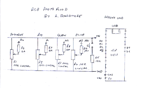

Step 2: The Circuit and 3 Videos
