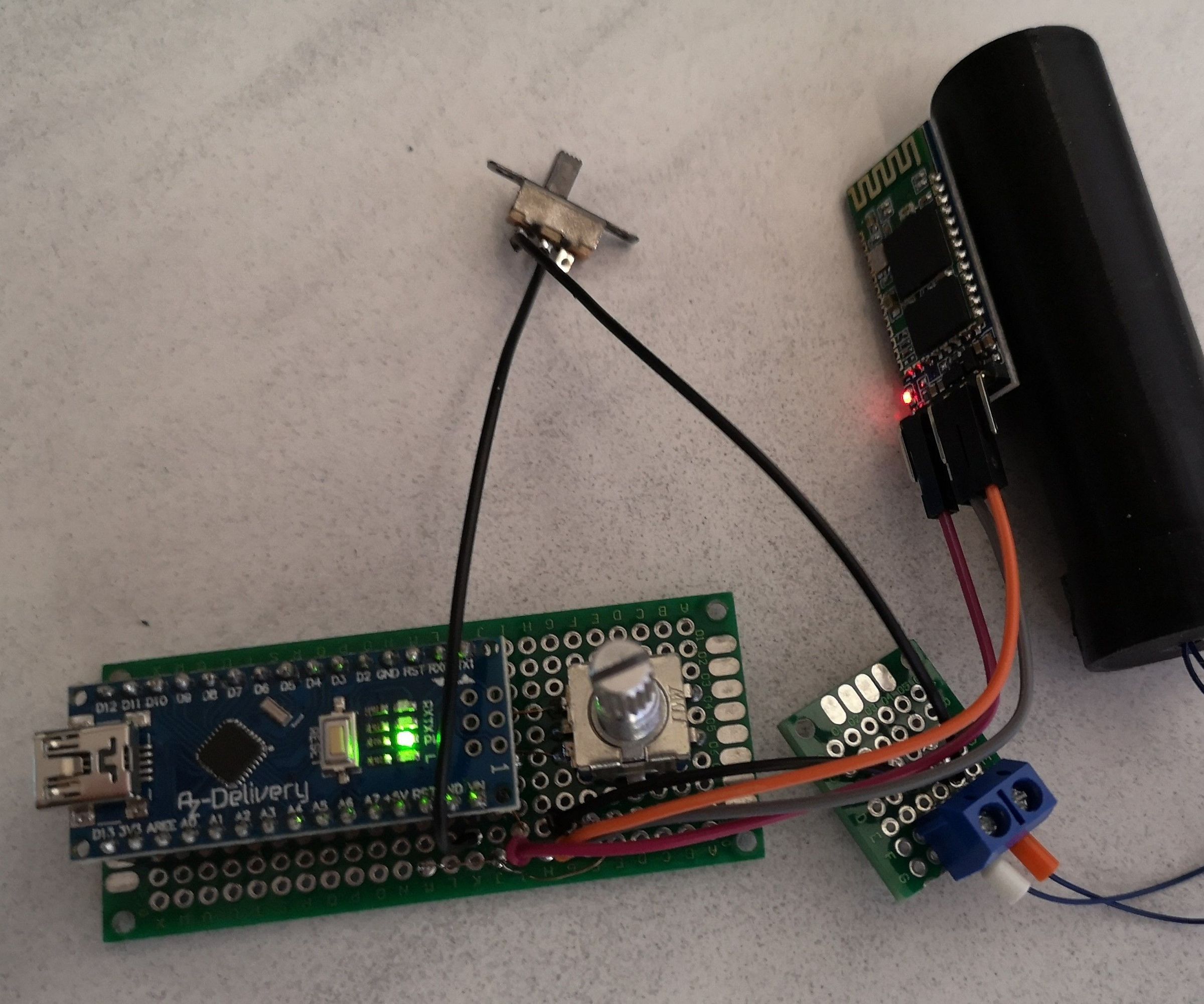

Gaming is fun. But RGB-Lighting is definitely essential for that. Since I wanted to make a small, portable light that can be controlled with a Smartphone I made my own one. I called it RGB Pocket-Light. It is lightweight, portable, bright and has definitely a lot of functions. It can be used as a decorative mini-light that can be carried around and charged up over it's USB-C-Port.

Since I just want to upload the program once to the ESP12 and don't want to change it I didn't add any programming-pins to the PCB. To make my life a bit easier I used this 7€-ESP-Programmer that I can definitely recommend when working often with ESP-modules. You can just put in the ESP-module, connect it to your PC and program it as any normal ESP-Board.
The software I used for this project is invented by Aircookie and called WLED (https://github.com/Aircoookie/WLED). You can integrate it in any Smart-Home-Application and control it either in the Browser on your Smartphone or your PC, emulate an Alexa-Device, connect it to your MQTT-Server and much more! I really love this project since you can control any RGB-LED's with an ESP-Board very easily with hundreds of effects. It is really well documented and worth to check out. But of course you can also program your very own code for the ESP-module.
