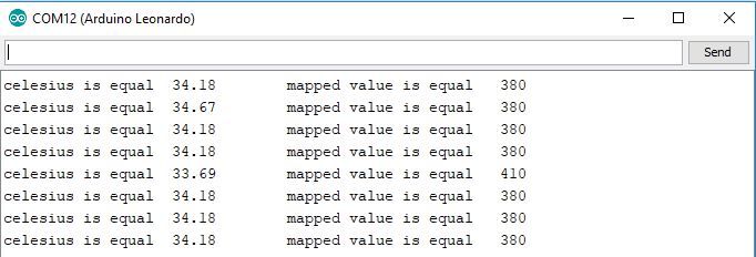

Step 5: The Final Code
Now that we have everything connected to our PICO, lets start programming it so that the LEDs change color depending on the temperature.
For this, we need the following:
- A const. variable named "tempSensor" with the value A0 which receives its reading from the temperature sensor.
- An integer variable named "sensorReading" with initial value 0. This is the variable that will save the raw sensor reading.
- A float variable named "volts" with the initial value 0. This is the variable that will save the converted sensor raw reading value to volts.
- A float variable named "temp" with initial value 0. This is the variable that will save the converted sensor volts readings and convert it into temperature.
- An Integer variable named "mapped" with initial value 0. This will save the PWM value that we map the temp variable into, and this variable controls the LED strip color.
Using this code, PICO will read the temperature sensor's data, convert it into volts, then into Celsius, and finally it maps the Celsius degree into a PWM value that can be read by our LED strip, and that is exactly what we need.
