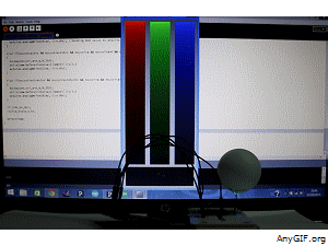

When we run a processing project, the opened window has a certain width and height and every shape such as buttons, lines, etc. are sized to fit that window in some aesthetic/functional way. But what if we want or need a larger window; or a smaller one? Should we need to re-size everything?
To keep things proportional, I sketched on paper the desired aspect for the window. Then, always thinking in percentages, divided the window in useful areas and borders as you can see in the image above.
In this case I came up with these proportions:
80% for the columns width and 20% for borders and spacing's, so b=80%*width/number of columns, c=20%*width/number of columns.
//Automatic window and column re-sizing
float b=0.8*w/3; //default is at 0.8;
float c=0.2*w/3;
float a=c/2;     //c=2*a
float d=h-3*a-b;
float e=w-c;
Column:
Each column was made by several colored lines and as the column height vary with the window height, so does each lines color. To deal with this I used the map function witch is very useful in, well, mapping values between a given range.
To see one column appearing slowly, you can run the "One column" file in processing.

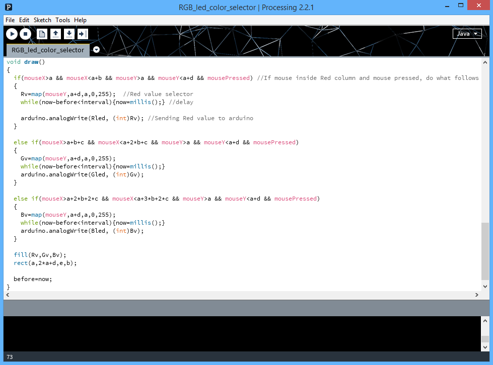

Communicating with arduino:
What happens in the main function of the code:
void draw()
if(mouseX>a && mouseX<a+b && mouseY>a && mouseY<a+d && mousePressed)
//If mouse pointer inside red column and mouse left button pressed, do what follows
//The position of the pointer in this column will determine the red value to be between 0 and 255
Rv=map(mouseY, a+d, a, 0, 255);
while(now-before)
now=millis();
arduino.analogWrite(Rled, (int)Rv); //Sending Red value (from 0 to 255) to arduino
//Do a similar if statement to Green and Blue values. (shown in the source code attached)
//Show color in preview box
fill(Rv,Gv,Bv); //Values sent to arduino are the same as entered here
rect(a, 2*a+d,e,b); //draw bottom box (preview box)
before=now; //"Reset" delay
Step 3: Thoughts
This was a quick and simple way of communicating with arduino through Processing.
Such interaction between arduino and Processing is useful and powerful for a lot of cool aplications other than controling LEDs; you can control the speed of 3 DC motors with this code, for example (this would require a different wiring, though).
Using these color columns makes color selection intuitive and fast too.
The window resizing proportions are, maybe, not that intuitive, but they're pratical. If you need a smaller or bigger window, you only need to adjust the width and height parameters on the processing code and the window should resize all boxes to this new change in the parameters.
Now you can control a mood lamp easily by using arduino and processing.
