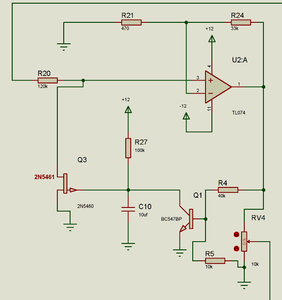

Step 2: The AGC
Here I will show you how to make the AGC part.
You need an OP-amp(U2:A), I used an Tl074, which needs +12V, GND and -12V, but you can use any OP-amp.
You just connect everything as the image, where the input of R20 is the audio signal (needs to be atleast 20mV)
I used a 10K pot to regulate the voltage out the AGC.

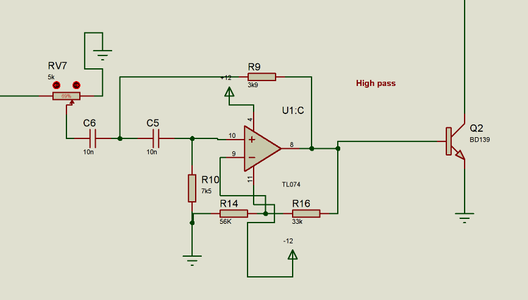

Step 3: Filter
I start with having an op-amp (U2:B) with a negative feedback loop from the output of the AGC to a potentiometer for the each of the three filters. The voltage then goes through each filter, and then to a transistor at the end driving the voltage to ground when it receives voltage. The potentiometers regulate the amplitude of the signal, which is useful if you for example want bass frequencies to light more than others.
In my schematic I have the cut off frequency for low tones at around 200hz, the start for middle at around 250hz.
Cut off frequency for mid tones is at around 2,3Khz and start for high tones at around 2,5Khz.
You can change all this to your liking by configuring the capacitor and the resistors in each of the filters. I used these calculators, which worked excellent:
low pass: http://sim.okawa-denshi.jp/en/OPseikiLowkeisan.htm
high pass: http://sim.okawa-denshi.jp/en/OPseikiHikeisan.htm
