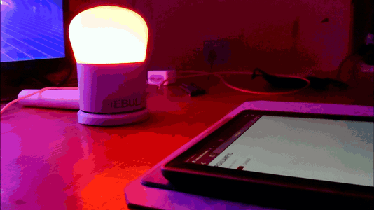

So here's my DIY RGB Desk Lamp/RGBLAMP. IO which is powered by an ESP12F Module and costs less than 20$. It has an internal lithium-ion battery and can be controlled via a web app.
My goal was to build a cheap Philips hue lamp alternative that has basic features like RGB LED Toggle and brightness control feature in less than 20$, so I made this Lamp!

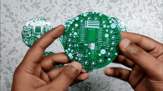

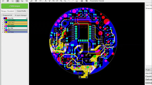

In the PCB editor, I put WS2812B LEDs in a Ring sequence and added the ESP12F at the middle and AMS1117 at one side. After Finishing the PCB and checking the whole board thoroughly, I exported the Gerber data and open it in the DFM software by the next PCB which you can download and use from here-
⭐Free PCB File checker: https://www.nextpcb.com/nextdfm.html?code=ArnovSh...
DFM software is basically a PCB Checker which you can download to check your PCB or Render your PCB before sending it for Manufacturing.
The DFM software can quickly open Allegro, Altium, Protel, PADS, Gerber, and other files for analysis. For example, when it finds out the open circuit it can repair it by editing the function.
In this software, I uploaded each Gerber layer and verify them one by one to spot any mistakes.
After checking the board thoroughly, I clicked on the render option to check out the rendered version of this PCB in green solder mask... After doing all the checking and rendering stuff, I placed the order straight from this software.
I Used NextPCB PCB Service for this project- https://www.nextpcb.com/?code=ArnovSharma check them out if you need great PCB service for a low cost!
⭐Register to get free $100 coupons: https://www.nextpcb.com/register?code=ArnovSharma
I received PCBs from NextPCB in a Week and working on its SMT Process.

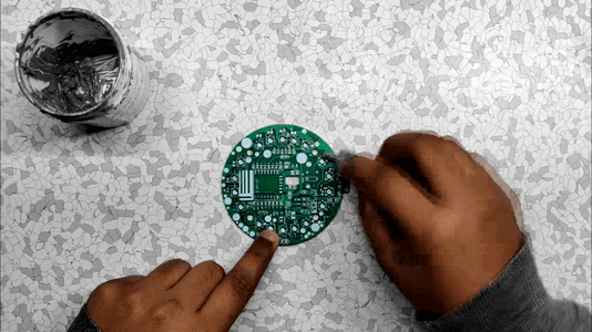

  • I first added the solder paste to ws2812b led pads and this process took time and effort as I didn't order stencil this time, and adding solder paste only one to each pad is such a pain.

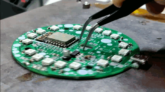

  • after adding the solder paste to each pad, I placed ws2812b LEDs on its assigned pads one by one in the right order.. placing them in the right order in reference to silkscreen is crucial as they won't work when you connect them wrong so be extra careful with this setup! after adding LEDs
  • I added 100nf capacitor to its assigned pads one by one, these capacitors can be placed in any orientation so we don't need to worry about the polarity.
  • after this, we just need to put the PCB on the hotplate and let it heat for few mins.
    just let the solder paste melts and remove the PCB in few seconds when the solder paste melts completely.
  • The result will be a PCB with 18 WS2812B LEDs soldered onboard.

after confirming that the PCB has been reflow properly, I added solder paste to every component pad and then added all the comments on their assigned place one by one according to the schematic.
(ESP12F, Resistance, AMS1117, capacitors, etc)
I added the PCB to the hotplate and let the solder paste melt (FUN FACT- Solderpaste that I have melts between 190-210°C but there are other Solderpaste that has a lower or higher melting temperature).

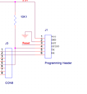

Step 3: ESP12F Programmer
For Programming ESP12F, we can use an FTDI module but there's also exist a better and easy method that required only a NodeMCU board.
I previously made a PCB which is an ESP12F Programmer board that contains a NodeMCU and few header pins. basically, we just need to connect any minimal ESP12F Setup with NodeMCU in this config.
We first pull down the enable pin of NodeMCU to GND which turns off the ESP12F on NodeMCU, we can just hook an extra esp12f setup and use NodeMCU's CP2102 chip to flash that. I already have made Instructables on this topic so you can check that out from here-
https://www.instructables.com/Program-ESP8266-With...
In the RGB LAMP PCB, I connected all the programming pins which are VCC, GND, RST, GPIO0, TX, and RST to a CON6 header pin.
For programming, we can directly plug the NodeMCU Programmer PCB onto the RGBLAMP's PCB CON6 Header Pin. It's a clever method to use as because of this external programmer, we don't need to add FTDI Chips on ESP12F setup and we can make smaller PCBs and for programming them we just breakout 6 important pins and connect our external programmer with it.

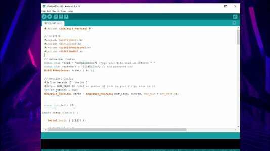

Step 4: CODE and Basic Testing
For Uploading code,
  • first, plug the NodeMCU programmer with the RGBLAMP's PCB
  • change the wifi credentials
  • select the Nodemcu as the mainboard in the tool option with the right port, and upload the code.
after uploading the sketch,
  • open the serial monitor at 115200 baud rate and hit the reset button.
  • you will see the IP address of the ESP2F setup.
  • copy the IP address and open it in your browser.

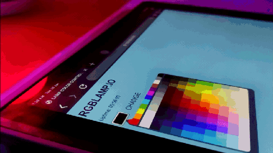

  • you will see the RGB LAMP. IO web server
The web server is not aesthetically appealing but it will let you toggle any color by clicking on the color palette and adjust brightness.

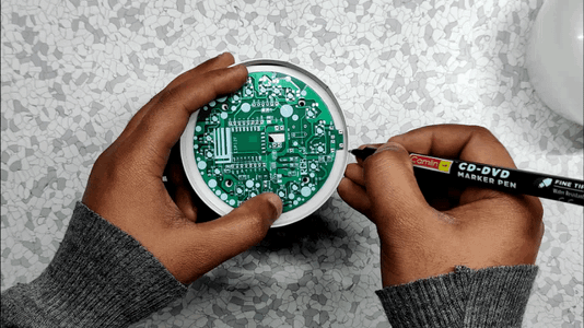

The Next step is to edit the metal body according to the PCB.

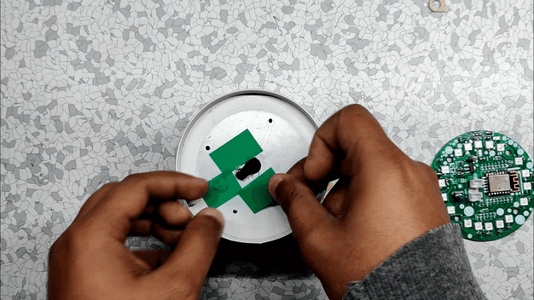

For starters, our PCB will be screwed on the top part of this metal lamp body, I made mounting holes in the PCB design but this body doesn't have a cavity or cutout for the USB charging port, so I marked the cutout length according to the USB size and use a hacksaw to cut that part out. I also made a similar cutout in the diffuser body.
After this, I drill holes in the metal body for the switch and battery wire with a drill machine and that is pretty much the editing part. we start the main and final assembly by first adding electrical tape to the metal body top part as our PCB might get shorted when placed on top of an exposed metal surface and that won't be a good thing so I cover the exposed metal part with electrical tape. after that, I placed washers or spacers on mounting holes to lift the PCB a little bit from the metal surface and used screws to mount the PCB on the base permanently.

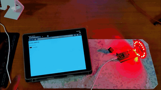

Step 6: RESULT
CODE is already loaded on this RGB LAMP PCB so we just need to turn on this device by toggling the rocker switch present on the lower base and open this lamp's web server.
  • Click on the Black rectangular block
  • Select any color from the color chart and BANG
