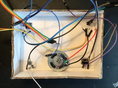

Place your Raspberry Pi Pico onto the mini breadboard like so, so the micro usb slot is facing the end, and the pin 0 is in line with row 1. Make sure it is also centered in the middle of the board. Go to step 7 for the pin out and wiring diagram. Place the LM386 Amplifier at the very end, and also the resistors.
Step 6: Case
To make the case, cut out 2 of each side pieces, and top and bottom pieces (the sizes depend on the use of your game and preferences) then on the top layer cardboard, cut out 4 holes big enough to fit your buttons. Then hot glue your buttons to the cardboard holes. Next, use a sewing pin to poke 4 holes beside the buttons (this will be for your 2 LEDs).
Then insert 2 of the same color LEDs (Red, Green, Blue, Yellow) into each of the 4 holes, with the longer probe facing the same direction. Then, twist the 2 opposite LED's opposite length probes together. Now you should have 2 probes from the LEDs. Repeat this step to all 4 (8 LEDs) sides.
Now, poke 4 holes for the RGB LED, and put it in. Next, connect the female end of female to male jumper wires to the buttons and the LEDs, note the + side and - side of the LEDs (otherwise it won't work). Now poke holes for your speaker on the top piece as shown above, after, hot glue your speaker on the edges to the cardboard.
Then hot glue the side cardboard pieces to the top cardboard piece, and pull the film off of the breadboard with the Pico, and stick it onto the bottom cardboard piece (opposite of the top). Lastly it's time for connecting the jumper wires to the breadboard.
Step 7: Pins and Wiring
Buttons:
Button1 (Red) -> GP0
Button2 (Green) -> GP1
Button3 (Blue) -> GP2
Button4 (Yellow) -> GP3
LEDs:
Red1 -> GP4 -> 100Ω -> GND
Red2 -> GP4 -> 100Ω -> GND
Green1 -> GP5 -> 100Ω -> GND
Green2 -> GP5 -> 100Ω -> GND
Blue1 -> GP6 -> 68Ω -> GND
Blue2 -> GP6 -> 68Ω -> GND
Yellow1 -> GP7 -> 100Ω -> GND
Yellow2 -> GP7 -> 100Ω -> GND
RGB LED:
Red -> GP12 -> 100Ω -> GND
Green -> GP13 -> 100Ω -> GND
Blue -> GP14 -> 68Ω -> GND
Speaker:
GP11 -> LM386 Amplifier -> Speaker +
Speaker (-) -> GND
!!! FALIURE TO USE PROPER WIRING AND RESISTORS WILL LEAD TO DAMAGING YOUR PICO !!! (I had to buy a new one after burning my current one form pulling too much current :( ... )
P.S. You will see pin # and description on the Pico's backside. It’s a bit messy wiring I have there, sorry :(
