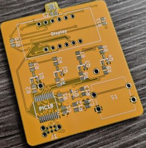

Step 1: Schematic / PCB Design
As you may see, the design is pretty forward: The pic18LF14k50 drives some NPN transistors, which allow the display to light. Same for the buzzer.
The display has four numbers in parallel, so we will need to have a high-frequency blink in order to "trick" the human eye to see them all light at the same time.
For the button, an RC filter made of a 10K resistor and 100nF will filter any bouncing effect.
Last but not least, the Humidity and temperature sensor is the HTU20D, which gives us the reading using I2C communication.
Step 2: Soldering SMD Components
Solder paste can be applied with a syringe or stecil. Afterwars, the SMD components must be placed with the use of some tweezers. It can be soldered in a hotplate or using a heatgun.

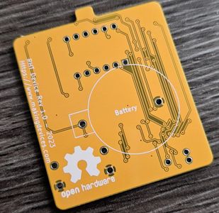

Step 3: Soldering TH Components
All the TH components can be placed and soldered by hand. It is recommended to cut the leads from all the components

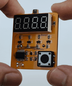

Step 5: Functionality
Instructions of use:
  • When the button is pressed, the temperature is shown. (d in last digit)
  • Next time the button is pressed, relative humidity is shown. (h in last digit) It will change between temperature and humidity
  • After 10s of no use, the screen will be off and the device enters sleep mode.
  • One button click will wake up the device for another 10s
Step 6: Power Consumption
One of the main requisites for the board is to obtain a minimum power consumption so the device can live from a coin cell.
  1. When the screen is ON we obtain: 10.69 mA.
  2. When the screen is OFF we obtain: 6.79 uA.
With this data and a normal use of 5 reading a day, the battery should last for several years.
