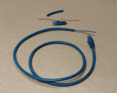

Step 3: Prepare the Patch Cable
Start by clipping the head off of the Cat5e patch cable and stripping off the outer jacket, as shown above.
Strip the patch cable enough to allow each pair to reach their designated spot on the patch panel. The image above shows the patch cable stripped to 2".
Clip off the unneeded pairs - Orange and Brown.
