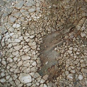

Step 2: Before
This is the condition of the driveway after many years of use. The rate of deterioration was slow at first, but accelerated. I imagine that the more cement that was missing, the more the remaining cement was unsupported sideways, allowing the fishnet to stretch and more cement to fragment and fall out.
Considering the thickness, about 1/2", I guess I shouldn't complain about the service it has given me; probably at least ten years.
