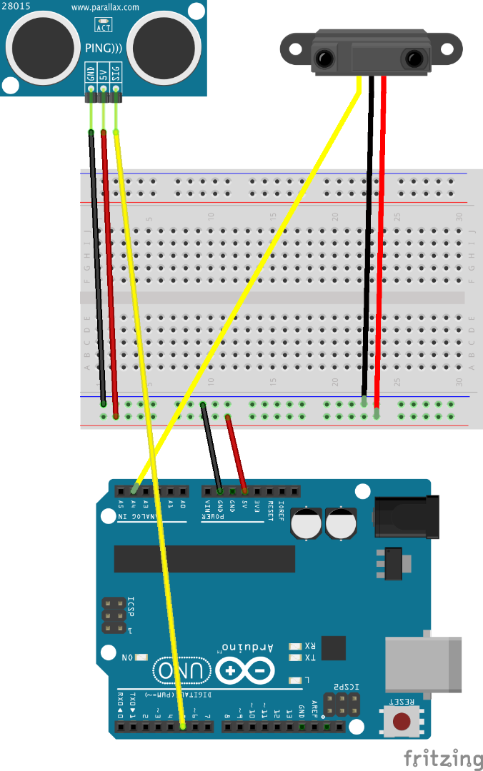

Step 3: Seeed Ultrasonic and Sharp IR Sensors
This diagram shows how the Seeed Ultrasonic and Sharp IR sensors are wired.

  • A4 – IR Sensor

  • 4 – this pin is used by the MC33926 Motor shield
  • 5 – Ultrasonic Sensor
